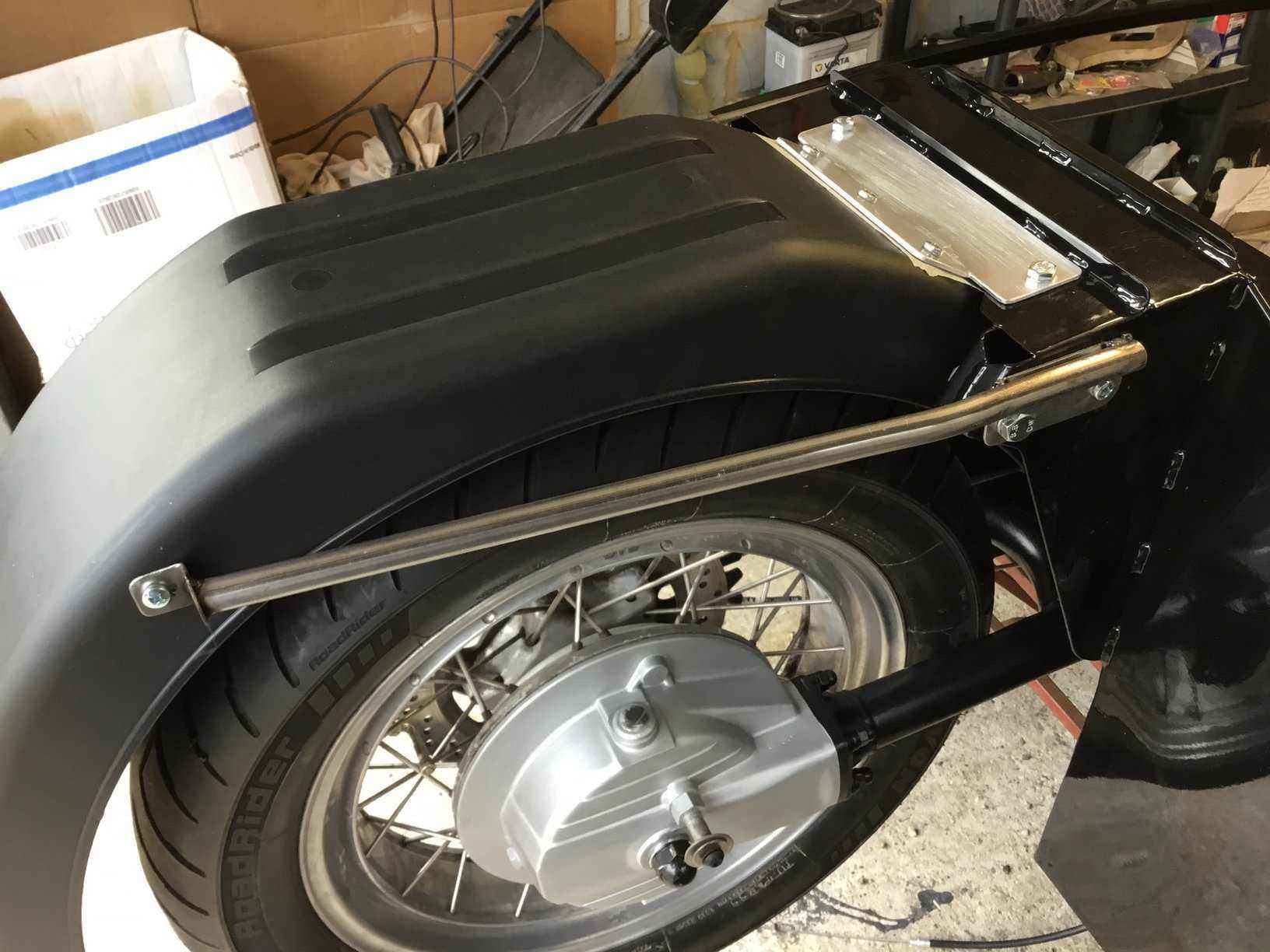

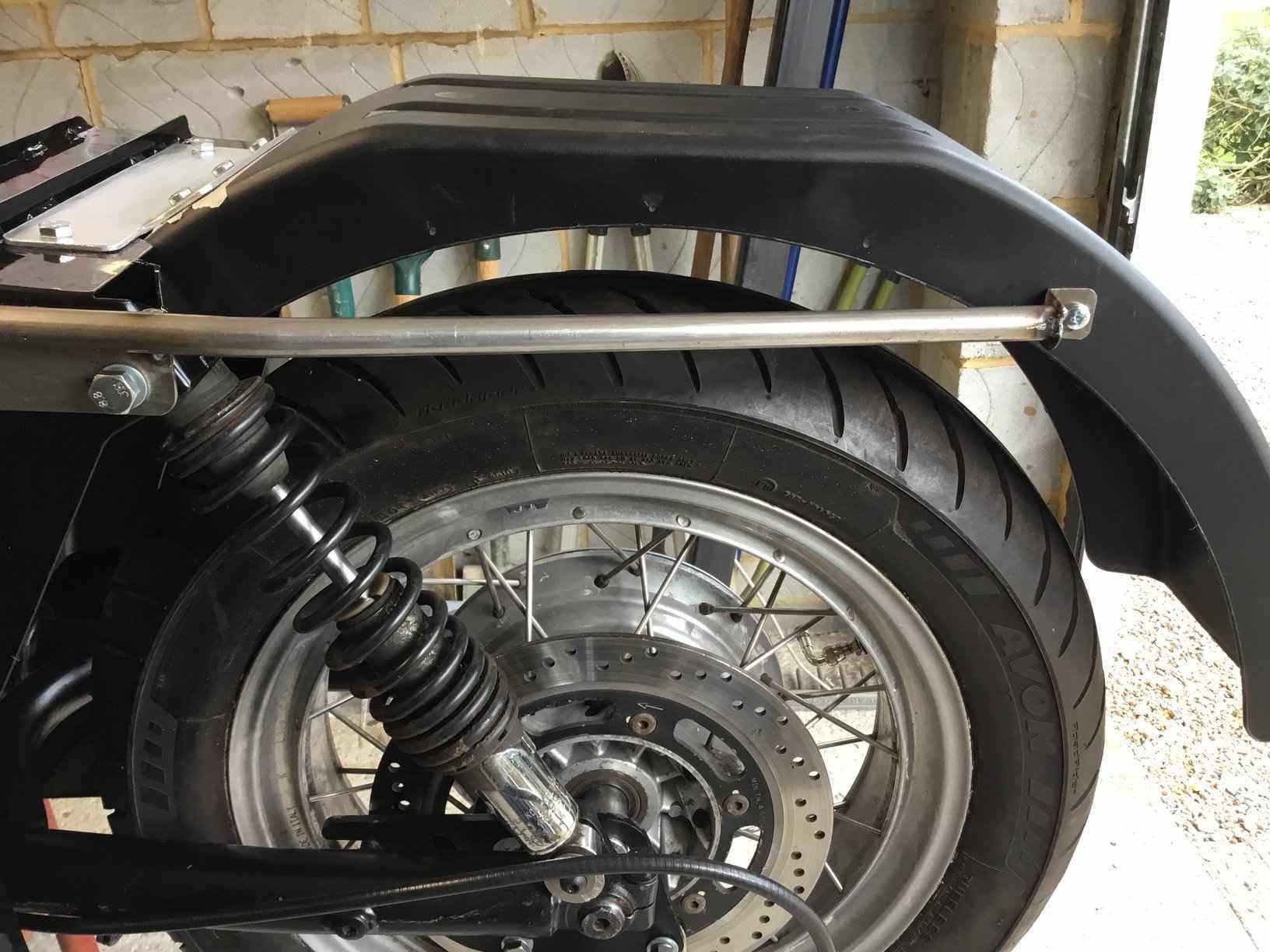

Have got chassis set up on trestles in garage and started build. Had a few problems with the rear brake bracket but Alan is making a new one to suit. Couldn’t resist fitting front suspension, went together easily and looks great. Decided to fit a rear mudguard to keep that area cleaner, bought a plastic one from Trident Trailers for £12 that seems just right. Made up the stays today, with a clearance of 80mm between wheel and mudguard to allow for maximum travel of suspension.

Any details on the rear mudguard stays please Tony whilst YP is still on the build stand. sr5664 at gmail dot com

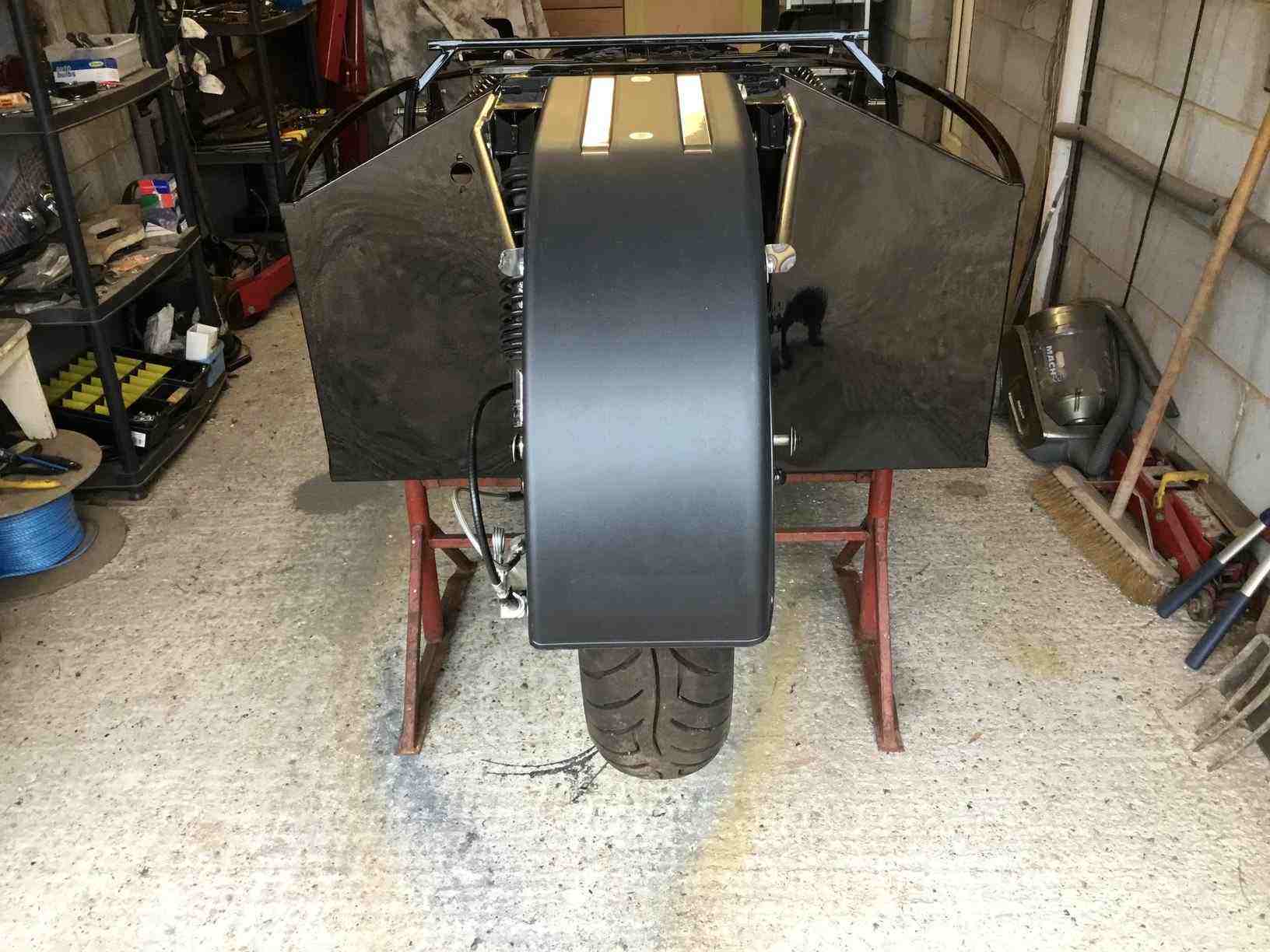

Hopefully will attach photos that failed previously - thanks for info from Richard.
Re: Type 3 build
Another pic. Stays are now painted ready to fit. Next job is to apply sealant to all areas that could trap moisture.
