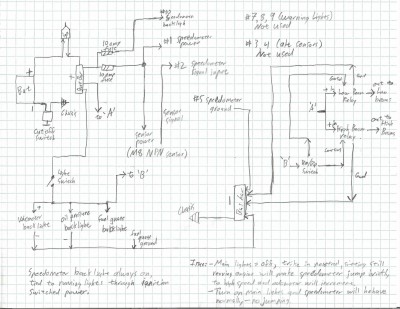

That leaves me with just one odd thing to troubleshoot and I am slightly stumped by this one:
- The speedometer and tachometer backlights are wired to always be on when the ignition is turned on (with the running lights).
- When running with the main lights turned off (whether sitting still and just revving the engine some or actually driving down the road), the speedometer with periodically jump around to a random speed (sometimes all the way to max) and the odometer will increment according to whatever speed it has jumped to.
- If I turn on the main lights (headlights and backlights for the rest of the gauges), the speedometer drops to where it belongs and behave properly.
I have gone through the wiring multiple times now, verifying the speedomter is otherwise wired correctly (except for the backlights).
Attached is a jpeg version of the hand-drawn schematic of the wiring as I have traced it. The power lines from the positive bus bar to the 10-amp fuses are actually separate lines for each fuse - I just drew one line as they go to the same poing on the bus bar.
I have made sure the ground bus bar to chassis connection is good and to clean metal (used a wire brush on a dremel to ensure the powder coating was removed under the bolt). I even added a second bus bar to chassis connection.
Any additional thoughts would be appreciated.

Is your speedo using a magnet [or two] to register the speed?

The sensor picks up 1 magnet and 4 hex bolt heads (all equally spaced) that hold the right front brake disk in place. The other 5 bolts holding the disk are socket head bolts and do not register/trigger the sensor.
I confirmed they register properly with the sensor: it has a built in LED for confirming spacing and triggering. I can lift that wheel, spin it by hand, and see the LED blink at the magnet and each of the bolt heads.
It was doing the jumps when sitting still as well as driving.
I added a power port for my GPS before yesterday's test drive and the brief tests with the headlights off did not result in any jumping. I suspect something very subtle in the wiring, but am unsure how to find it.

I don't know if you already know but the information on setting the speedo can be found on the suppliers site. The more pick ups the more accurate the reading.
