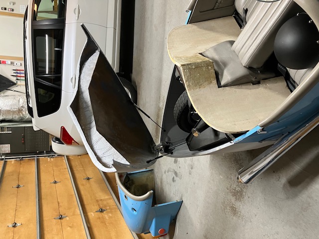

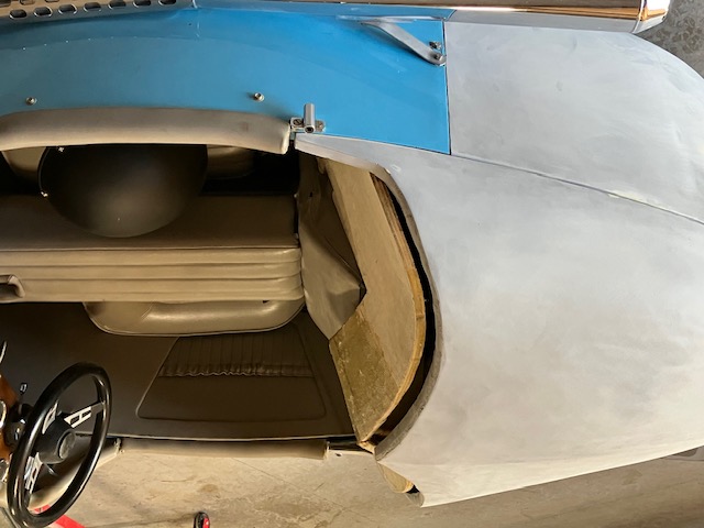

Quick update on the progress of the skiff tail modification to the Triking 3 wheeler. Tail is smoothed out now and in primer, struts installed, and hinge installed and adjusted. Still needs a little more smoothing, final paint, cockpit coaming lights and licence plate bracket and latch to complete. Pictures show original seat and purpose built seat back to show the gain in legroom and steering wheel reach (2" and 4" respectively.
