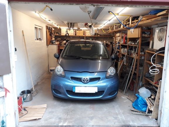

First off was to get somewhere to do the actual work, the garage was filled with a Saab 96 and >10 years of old saab parts but after a quite fast sell and 4-5 days of cleaning, moving stuff around and painting walls its actually useful as a small workshop. It's not large but one of many reason that i choosed a Triking was it's nimble size. :D
