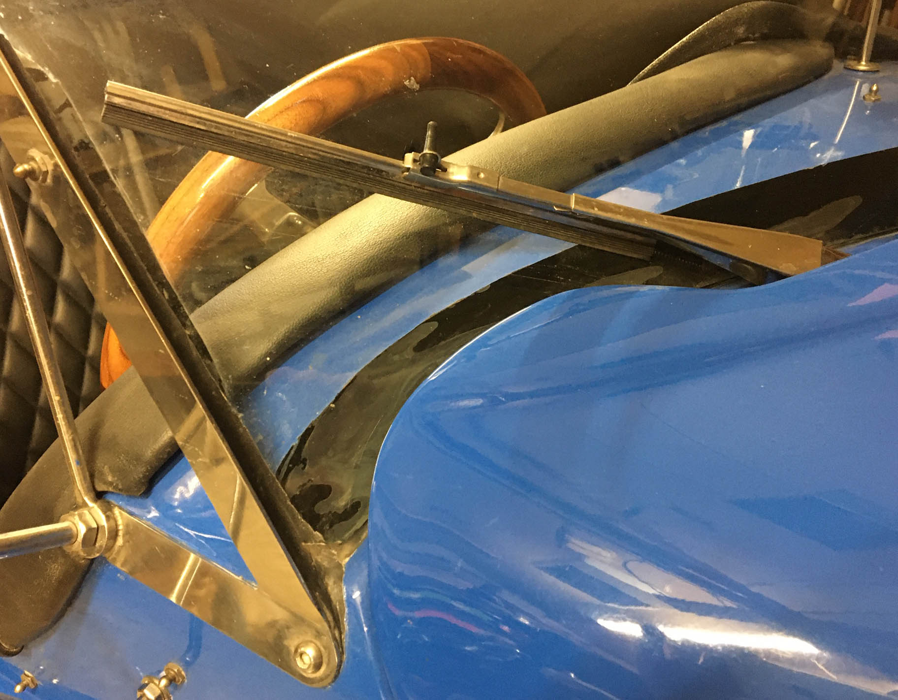

To get through the MSVA with a windscreen fitted, you need to have wipers and a demister.
So, in practical terms the screen is not fitted until after the MSVA. Let’s not worry about any retro-fit.
We all like to go out in the dry but we can get caught out. With ‘Rainex’ on the screen it will allow the air flow to keep the screen clear provided you are going over 30-40mph. Under that speed your vision will be seriously impaired.
That is the point in time when wipers are essential not just for your own safety but other road users and pedestrians (inc here sheep, cows, deer, goats).
If you are building or having one built, think seriously about including wipers in the spec.
It’s a small price to pay for a safer Triking.
Windscreen Wipers
Re: Windscreen Wipers
I was really glad of them at last years Yorkshire meet in the torrential rain on the Saturday. They look tiny but are surprisingly effective and worked happily for hours!
I agree wholeheartedly Richard.
Wipers are going on Wipee.
