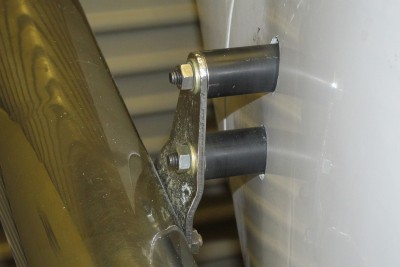

I made up a pair of pillars to carry isolastic mounts. Then I attached the original bike silencers but was disappointed to find that the silencers were too heavy. I had chosen quite hard grade mounts but even so the silencers flobbled (a technical term) around on them. This wobbly mounting would actually introduce vibration, not reduce it. So the idea was rejected.
Instead I have made up simple spacers and long bolts onto the original silencer mounting brackets. This gives a good solid attachment and looks neat.
Attaching in the usual place the double mounting might be a bit over-engineering, but the isolastic system called for two so I had cut holes in the bodywork. So I have two mounts regardless.
- Exhaust mount external view
I will be using nylock nuts on the final version to avoid littering the highway.
