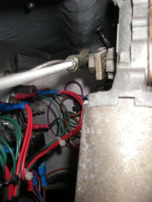

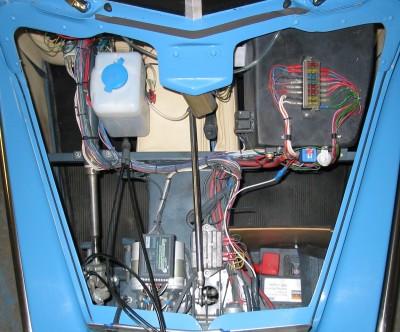

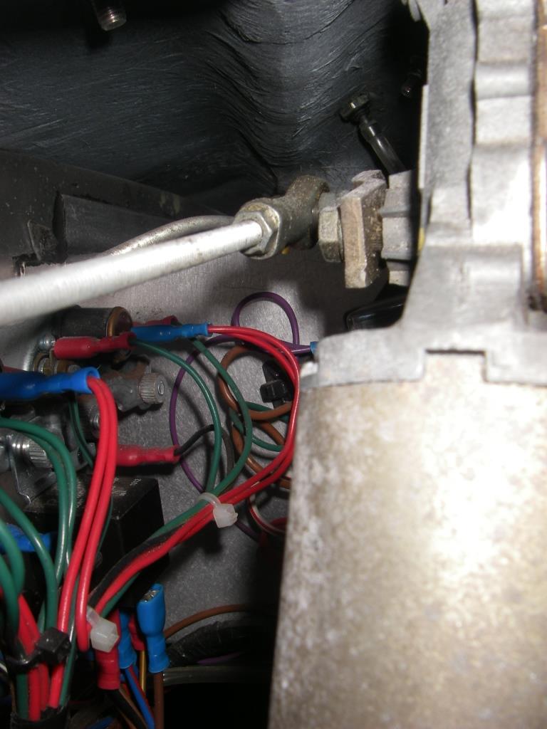

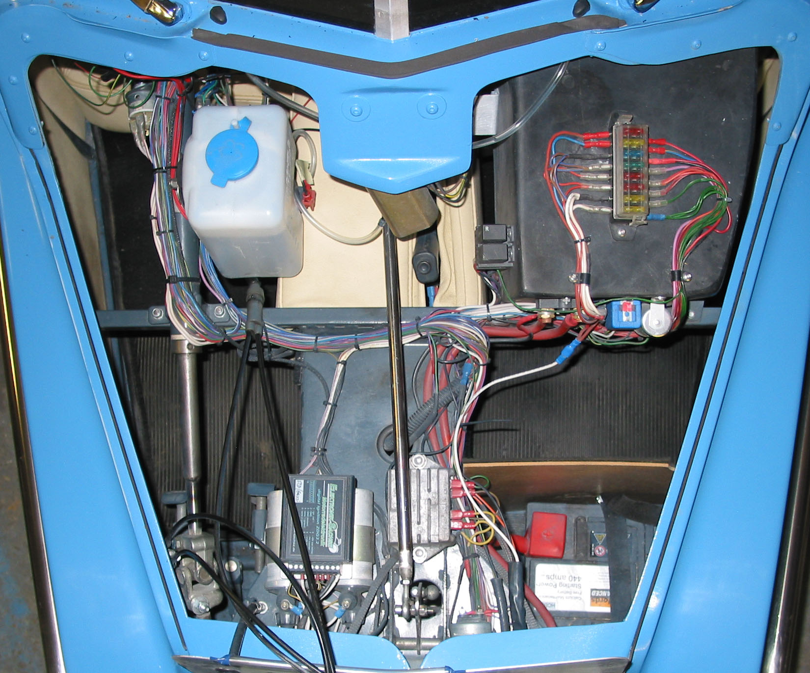

First picture was Florence.
This is Edith, just took the bonnet off specially to take another picture!
Note the strut to give more stability to the G/F mounting area.

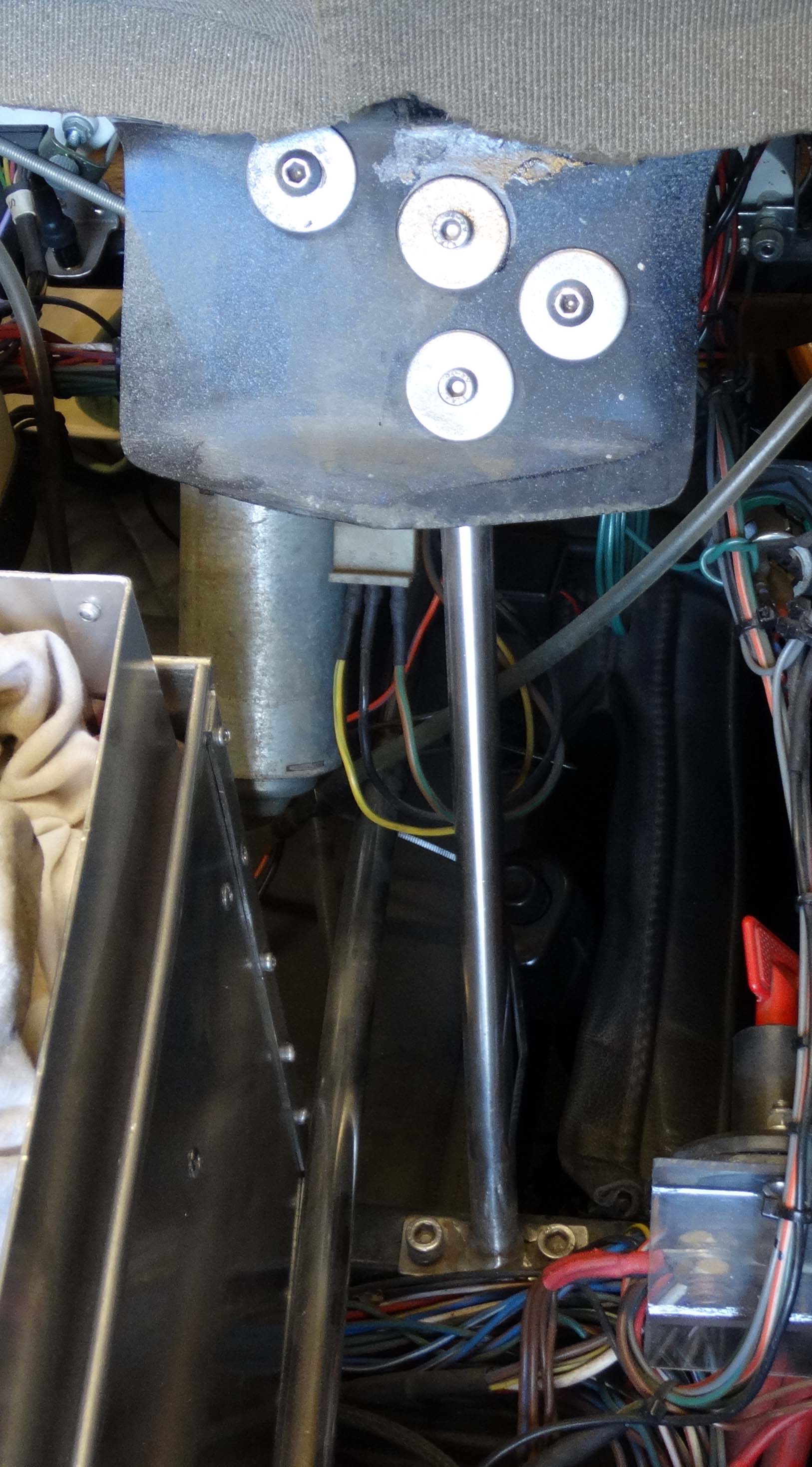

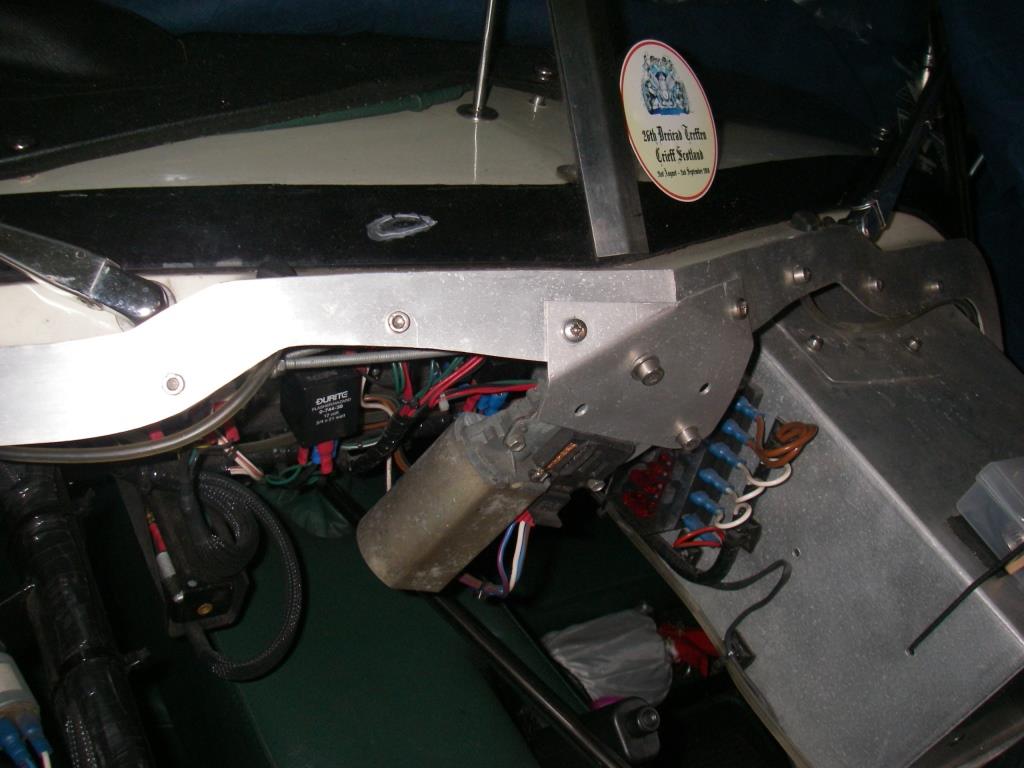

Post by Oleg » Fri Mar 22, 2019 2:52 pm
Oleg's installation. The only thing I would add is that you will find it useful for future access to cut a port in the top of the glove-box.
