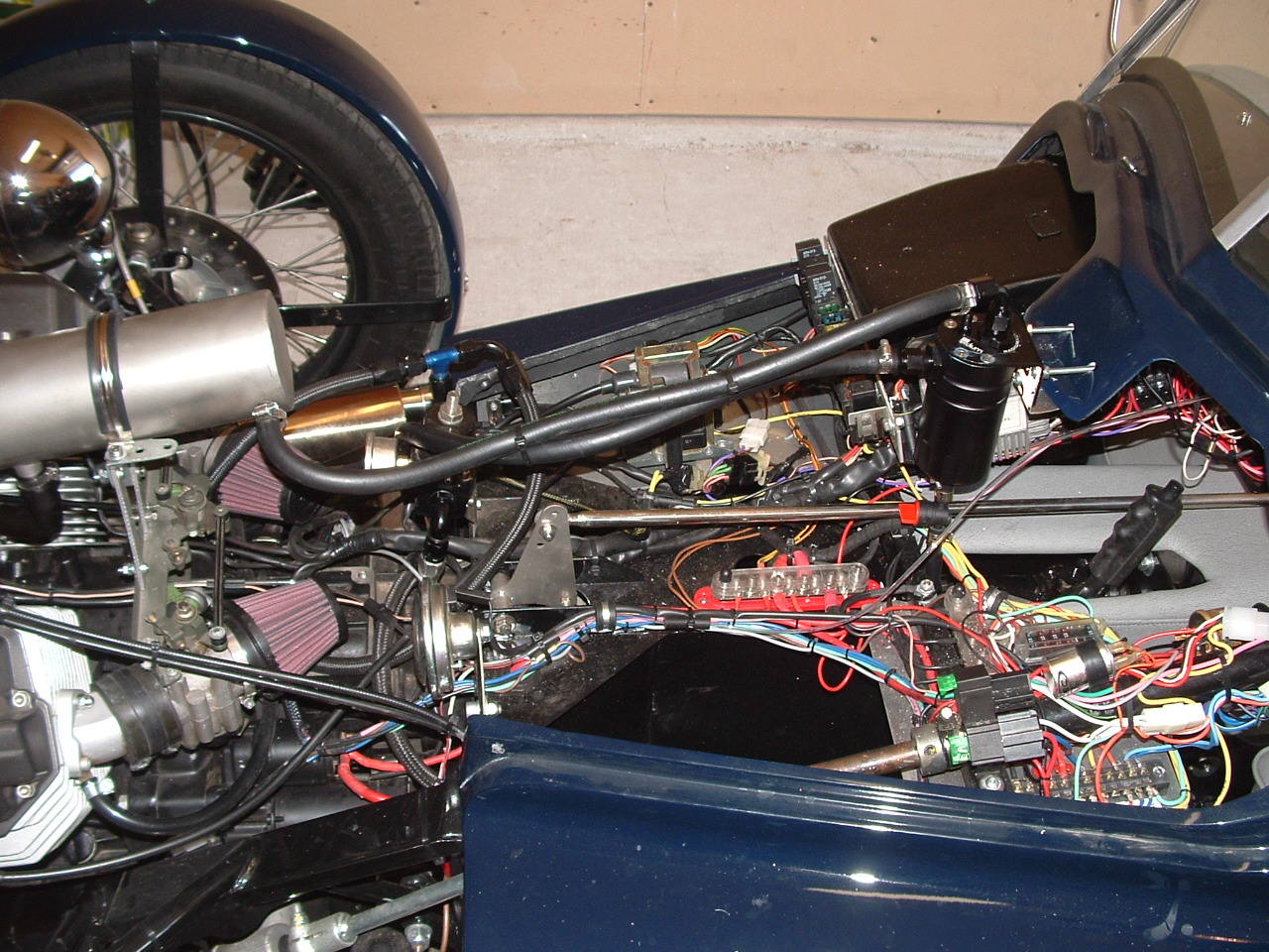

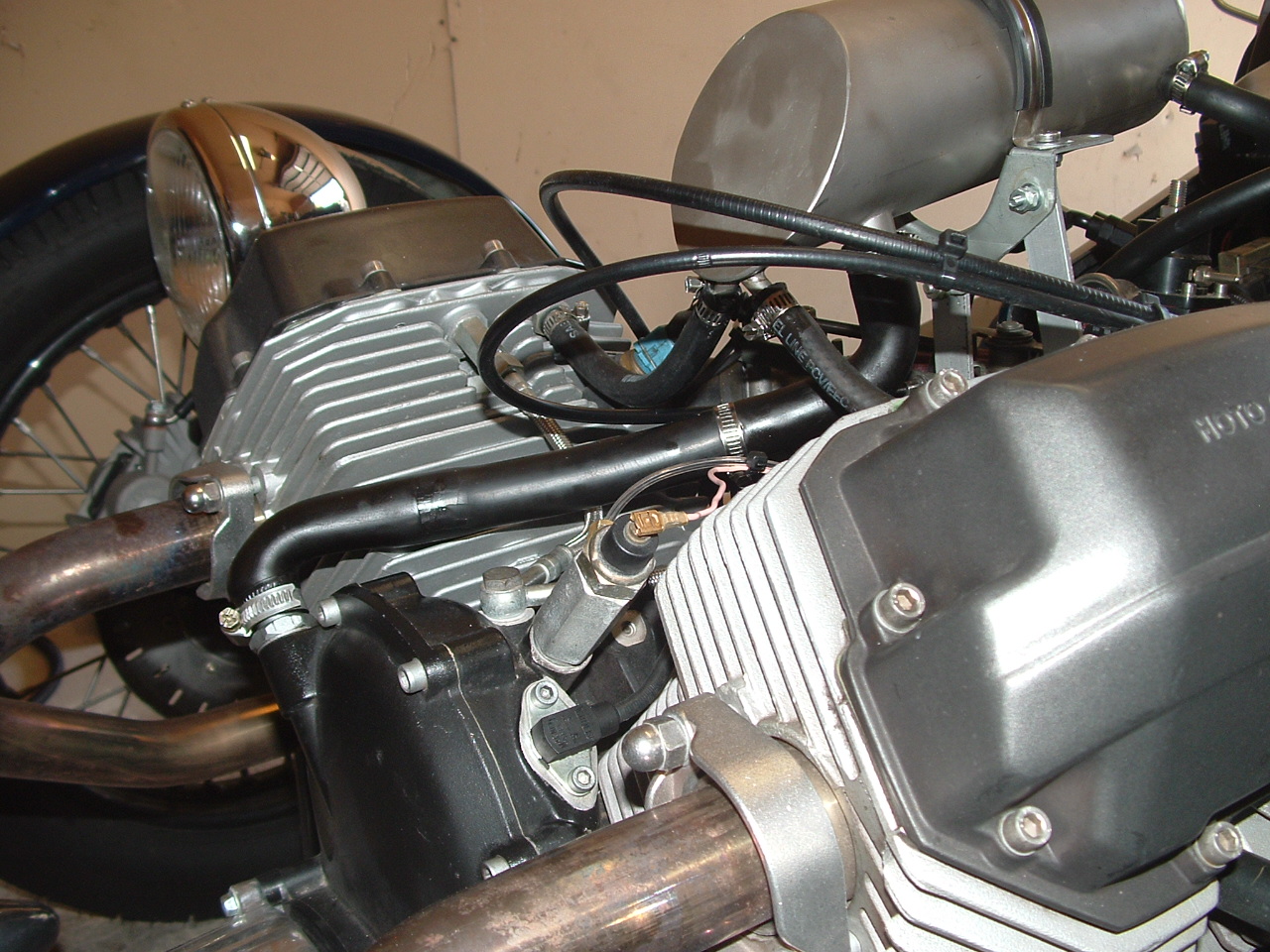

Pictures of the completed efforts.

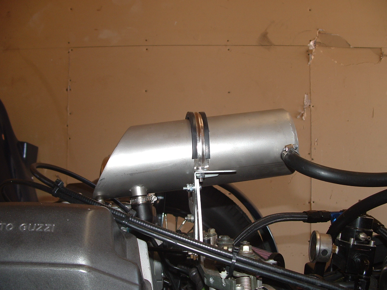

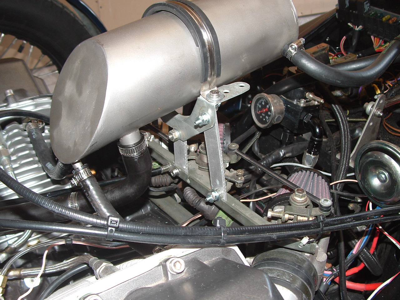

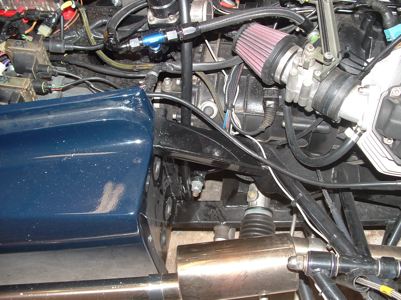

1) The return hose now has the more proper downward slant to the front. The connections at the engine for the oil pressure gauge and warning light are also tidy.
2) The new riser and stabilizer for the original breather/condenser tank.
3) The tank now has a slight downward angle to the front as well - lifting the vent port a bit higher than the return port to better encourage proper draining through the return hose.
4) The plumbing for the new "secondary" oil catch can is up higher and has no "low spots". I zip-tied the new catch can's vent-to-atmosphere line to the feed line from the orignal tank for more stability. They both follow the same gentle rise back to the new catch can slightly above the original tank.
Re: New build teething issues

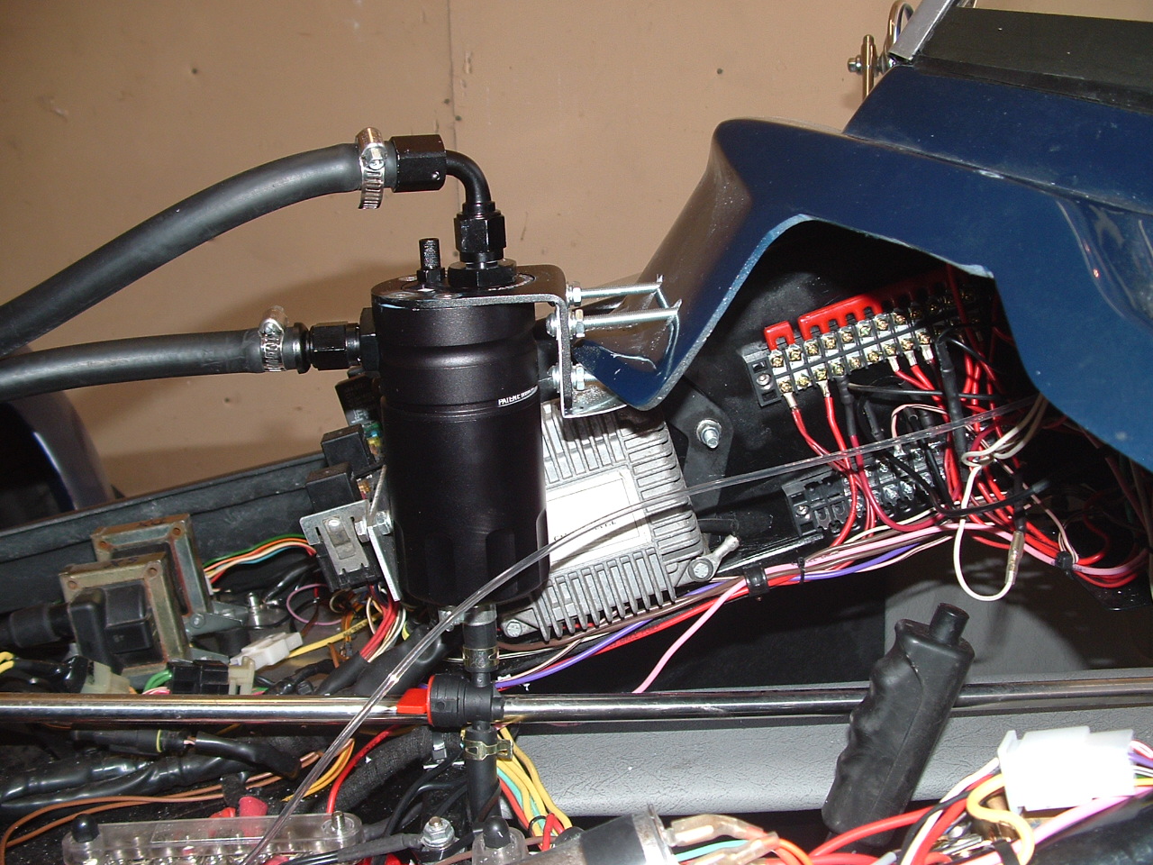

5) The new "secondary" oil catch can is securely mounted to the body tab at the scuttle. I fabricated a metal "mount plate" from an old motorcycle license plate. It forms a distorted 'U' from the catch-can's mounting plate, under the body tab, and up the back of the body tab. The top bolts go the the catch-can's mount, across and through both the body tab and the fabricated plate. The fabricated plate acts as a spring-washer against the nuts and washers on the back-side. The catch-can also has a drain hose with a petcock valve for draining that I routed to under the car where I can slide a drain pan if/when necessary. It is routed such that it does not interfere with anything in the tunnel as well.

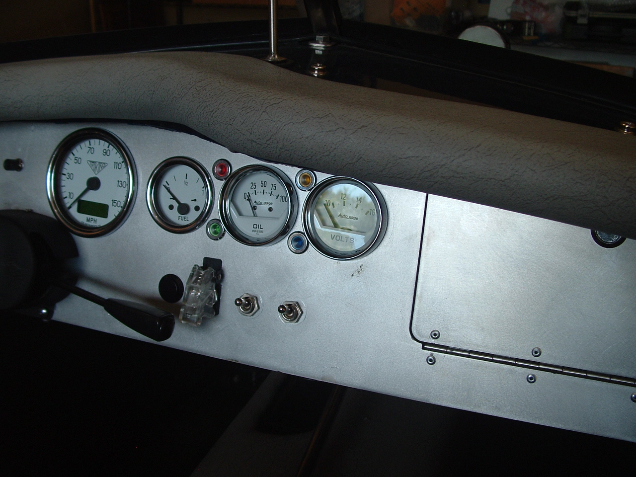

6) The newly installed mechanical oil pressure gauge and voltmeter. They are close enough in appearance to the other gauges that I am happy.
7) I routed the vent line from the new catch-can to the right front so that if it does ever spit oil, it will go under the car and not be in the path of the rear tire.

I got out to the garage for a short while - enough to verify everything and fire it up for static testing.
All seems to check out well. The voltmeter shows the expected voltages at key-on, start, revved, lights on, etc. It increases as revved, drops a little when at idle, drops a little when lights are turned on, etc.
I am happy it will let me monitor the charging system.
The new oil pressure gauge is also working as expected. It went to about 65 - 70 psi at cold start. As the engine warmed up, it would start dropping some at idle and go back up to that same range when revved. There did not appear to be any leaks either.

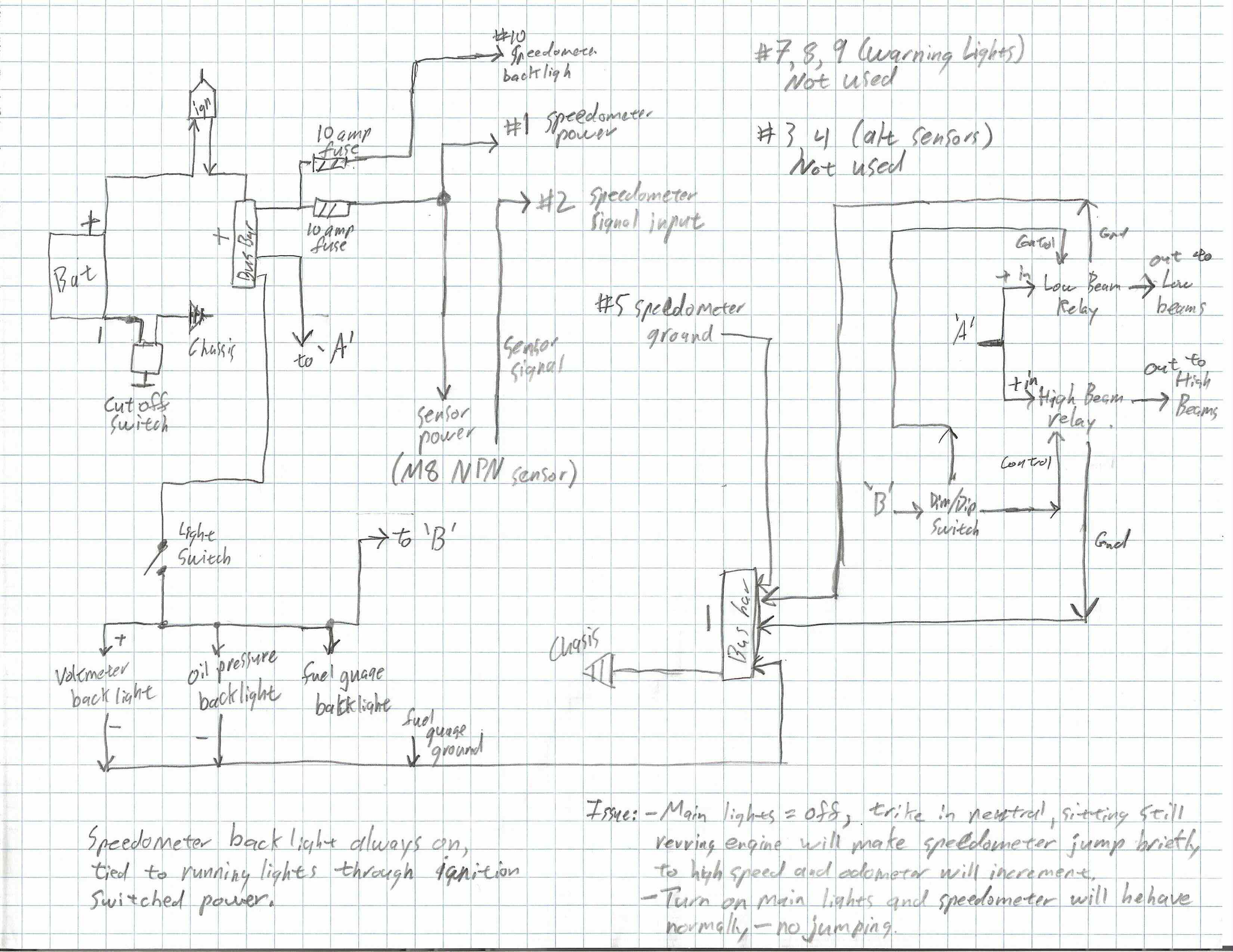

That leaves me with just one odd thing to troubleshoot and I am slightly stumped by this one:
- The speedometer and tachometer backlights are wired to always be on when the ignition is turned on (with the running lights).
- When running with the main lights turned off (whether sitting still and just revving the engine some or actually driving down the road), the speedometer with periodically jump around to a random speed (sometimes all the way to max) and the odometer will increment according to whatever speed it has jumped to.
- If I turn on the main lights (headlights and backlights for the rest of the gauges), the speedometer drops to where it belongs and behave properly.
I have gone through the wiring multiple times now, verifying the speedomter is otherwise wired correctly (except for the backlights).
Attached is a jpeg version of the hand-drawn schematic of the wiring as I have traced it. The power lines from the positive bus bar to the 10-amp fuses are actually separate lines for each fuse - I just drew one line as they go to the same poing on the bus bar.
I have made sure the ground bus bar to chassis connection is good and to clean metal (used a wire brush on a dremel to ensure the powder coating was removed under the bolt). I even added a second bus bar to chassis connection.
Any additional thoughts would be appreciated.

I did most of the run with the main headlights on, but did do some brief stretches with them off and the speedometer behaved the whole time - go figure! I am really baffled by that one.

Is your speedo using a magnet [or two] to register the speed?
The sensor picks up 1 magnet and 4 hex bolt heads (all equally spaced) that hold the right front brake disk in place. The other 5 bolts holding the disk are socket head bolts and do not register/trigger the sensor.
I confirmed they register properly with the sensor: it has a built in LED for confirming spacing and triggering. I can lift that wheel, spin it by hand, and see the LED blink at the magnet and each of the bolt heads.
It was doing the jumps when sitting still as well as driving.
I added a power port for my GPS before yesterday's test drive and the brief tests with the headlights off did not result in any jumping. I suspect something very subtle in the wiring, but am unsure how to find it.

I don't know if you already know but the information on setting the speedo can be found on the suppliers site. The more pick ups the more accurate the reading.
