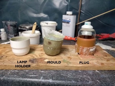

Having made the new tail section I've been trying to work out the best way of mounting the rear lights, which need to fit within a tube to look stylish. Having scoured the house and garage for inspiration I decided the only solution was to make some bespoke mounts out of fibreglass. The design caused much head scratching because I wanted to use ready made items for the plug in order to save time and effort. Then one day, whilst making a cheese sandwich I looked at the pickle jar in a new light with it's tapered and parallel sections and realised my quest was at an end!
Fibreglass work generally needs a plug to a take a mould off so this little project is a good illustration of the process. My plug consisted of the pickle jar lid screwed onto a piece of scrap ply so that the jar was rigidly mounted upside down. I then cut a piece of 3" plastic waste pipe down and chamfered one end, the pipe inner was an interference fit with the glass jar so was held firmly in position. Finally, I cut another piece of pipe and put a slit down one side so it would go over the main pipe and act as a depth gauge when laminating. The photo below shows the plug on the right.
The final work on the plug was to give it lots of wax polishing and then paint on the PVA release agent. Once that is dry the gel coat can go on and then it's left for a couple of hours until tacky. Finally, laminating resin and several layers of chopped strand mat are applied and left to cure for a few days. I trimmed the mould whilst it was on the plug so I had an accurate shoulder for the lamp to butt against. The final action was to drill a hole in the end of the mould as the cable would be going through anyway and it also lets air into the bottom of the mould to help release the mould off the plug. You can see the mould in the middle of the picture with a newly laminated lamp holder inside it. To the left you can see a lamp holder I made earlier.
I had to be careful when laminating the lamp holder that I didn't make it too thick otherwise the lamp holder would not fit within it, I confess I was slightly out on the first one but if you work on fibreglass when it's still green (not fully cured) it's much easier to trim and cut the laminate which is what I did. So, it all worked ok and the picture below shows the tail lamp inside the holder which for the moment is just resting on the new tail section.

by EricStarmer
Great work and description, Dave - you appear to be a fibreglass expert now, and the result looks great ! It's amazing how inspiration comes at the strangest times and from the strangest things - like Einstein said "Imagination is more important than knowledge "
