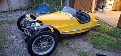

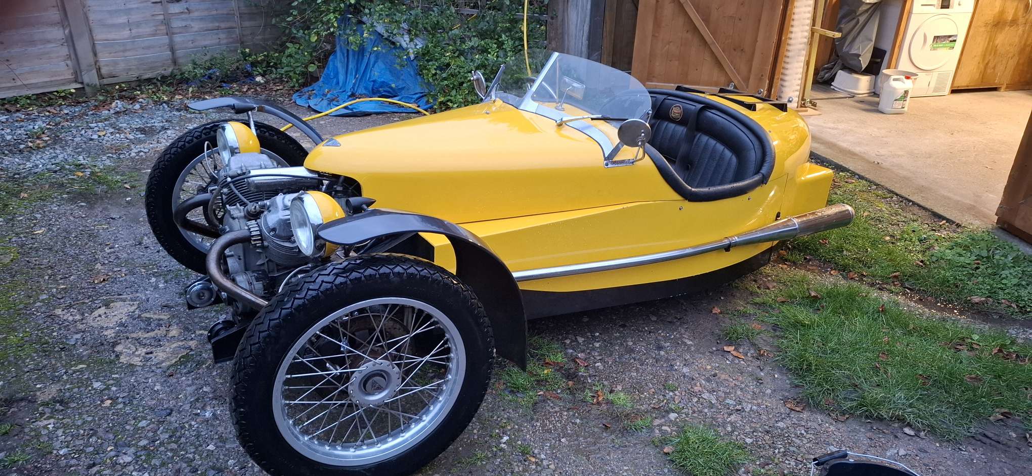

Hi all,
I'm new to Triking ownership although I'm not new the Trikings.
I've been given my Dads Type 1, 1986 vintage.
She is in a fairly sorry state, the salt air down in Cornwall has corroded all of the chrome plating, alloy is furry etc.
However I have two issues to sort out that I know of at the moment.
First of all, the fuel pipes have perished, the rubber pipe runs from the the carbs through a bulkhead into the centre tunnel up to the electric pump situated near the back of the tunnel. Is there a way to get into the tunnel, to pull the new pipe through, would you replace the rubber pipe with a metal one?
The second problem is one that my Dad had had before the trike was laid up.It is very difficult to engage first gear, i tried to adjust it back then and had little success, he had previously replaced the rear engine oil seal, so it's been apart, but he doesn't remember if the issue was there before then.
Any pointers on any of the above will be very much appreciated.
Many thanks Conal

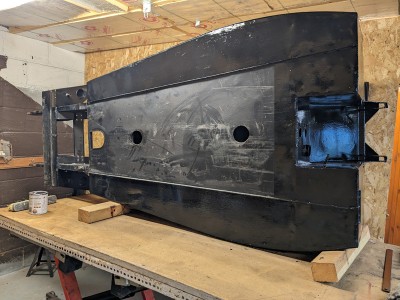

In order to gain access to the tunnel for the fuel hose (and the gearbox linkage) your best bet is to safely raise the whole Triking up as much as possible, otherwise you'll be on your knees, bending right over it. There is limited access to the tunnel from underneath anyway, as this picture of a Type 1 chassis on it's side that I recently restored shows.
Instead, you need to remove all the trim from the passenger side of the tunnel including any underfelt and you should find several holes in the tunnel big enough to get your hands in. It should then be fairly easy to replace the fuel hose with the appropriate new one. I would use hose with padded P clips myself.
