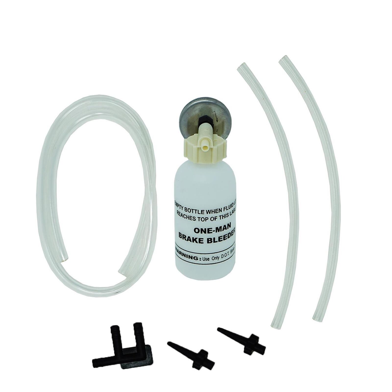

I use one of these [with an additional magnet] and a person to press the pedal.

Yes, I bought one of these, unfortunately. Badly made most of them. I went back to the bottle on a magnet. Old School it maybe but it is cheap and effective. Beware when choosing one.
