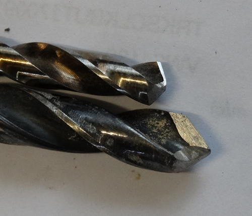

An easy way without spending loads of money on diamond tipped cutters.
Grind a negative cutting angle on normal twist drills, they will then be scraping the gel coat and not cutting into it making a mess.
Keep those selected drills for that purpose, they won't cut anything else.
For the bigger holes, stitch drill all round just inside of your cut line then finish off the rough hole with a file or coarse rubbing down paper on a big stick.
