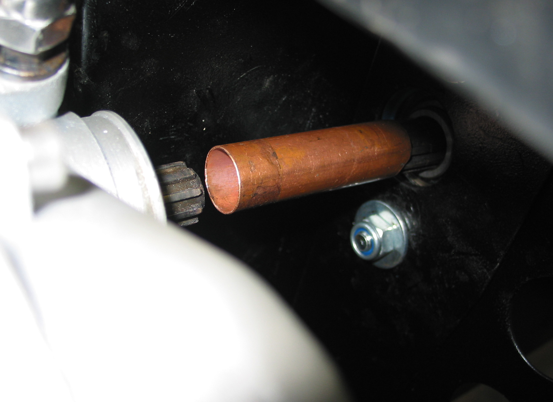

When assembling, I bolted the engine in place without the UJ, replacing with a piece of ¾” copper pipe to give a visual check. The self-centreing bearing could then be nipped up in the correct position, filing the holes in the chassis if not allowing movement to correct position.
Move the engine forward, torque down the bearing bolts then finally fit engine with the UJ in place.
