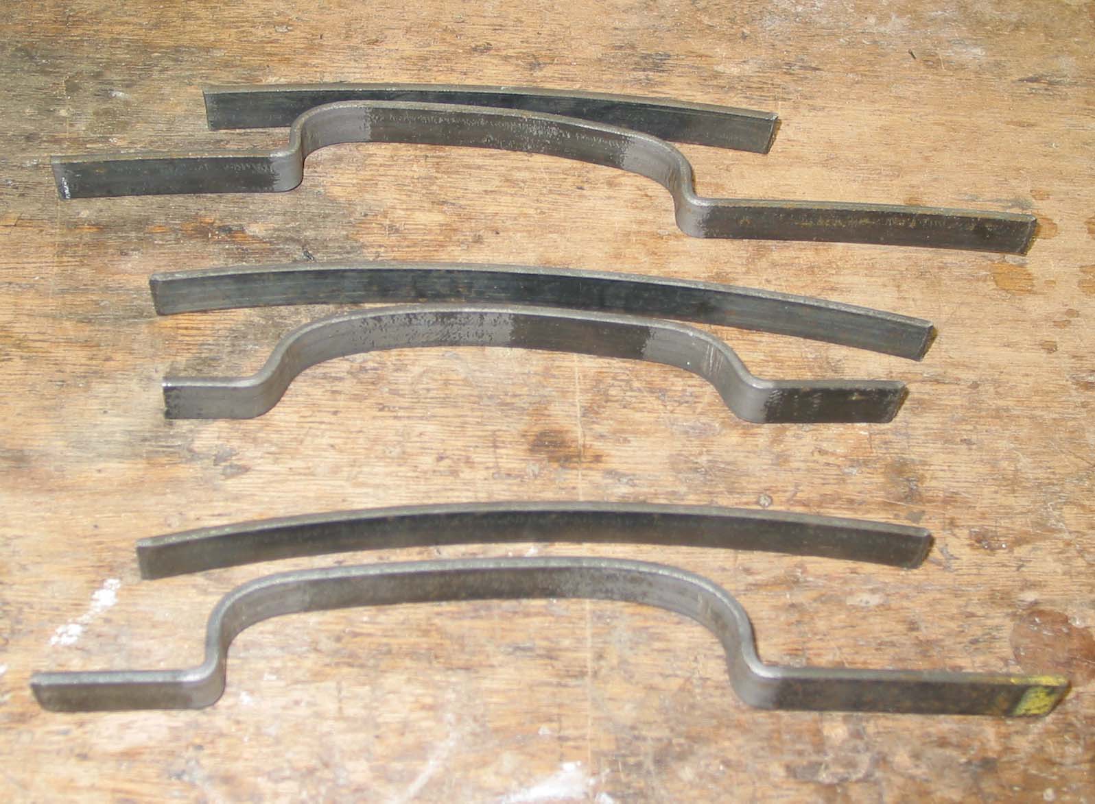

I am currently installing my front mudguards using Triking mild steel brackets. I found I had to do some careful bending (straightening) to make them clear the tyres. I have Heidenau sidecar tyres installed with a square profile. I now have about 15mm clearance between the bracket and tyre, so I am thinking this is sufficient. Comments invited please.

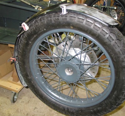

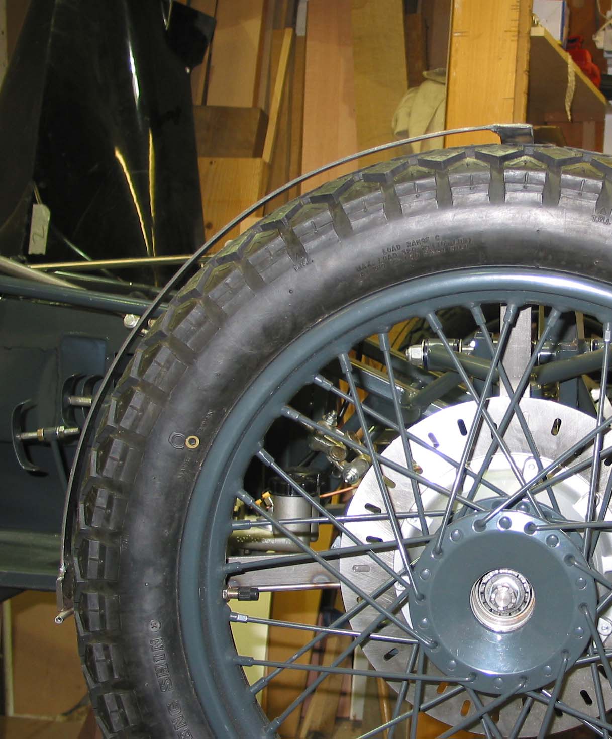

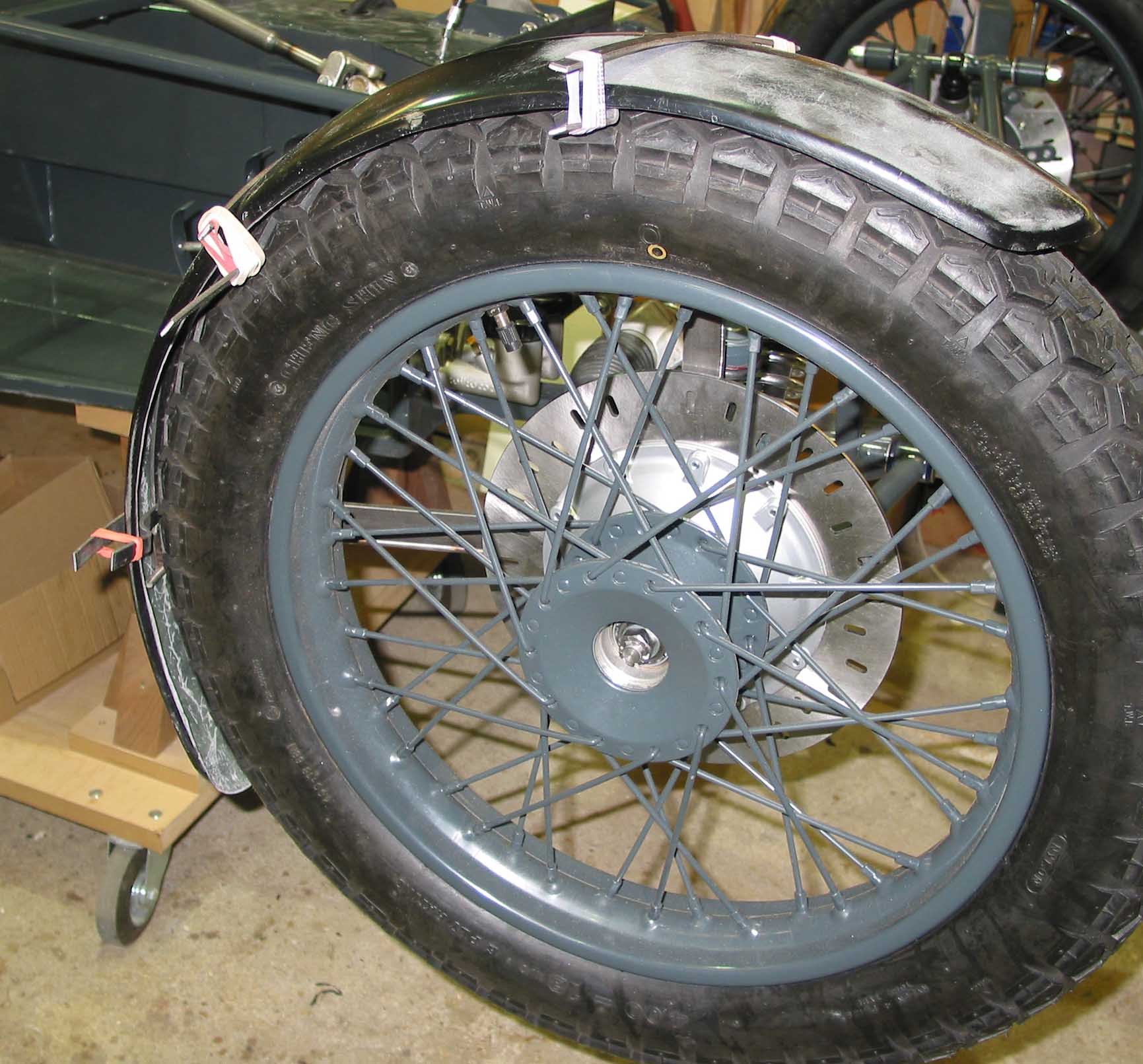

Pictures explain my method of holding them in correct place for 24 hours while the stuff sets.
You need the wheel in place to get the correct position.

Following Toy's method above has achieved the job satisfactorily three times so far. I used aluminium bar as it was more easily available at the time. [Guess who did not remove the security batten across the bottom of the shed doorway before relocating the build and removed the rear bottom edges of a new pair of mudguard blades.]
