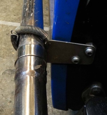

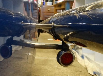

Good choice using the donor silencers, they're not too noisy. Mounting holes are in the right place.
I think the original bracket and long bolt/tube arrangement, supplied by Al, bolted through the rear chassis upright gives enough flexibility for expansion.
I did away with the balancer pipe (first bit to hit the ground going out of my drive) and expansion cans.
The support they gave is replaced by bespoke 'slipper' brackets.
Works well for me 8-)

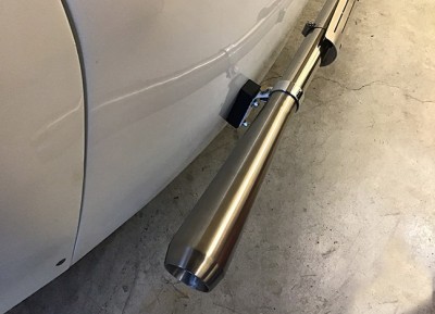

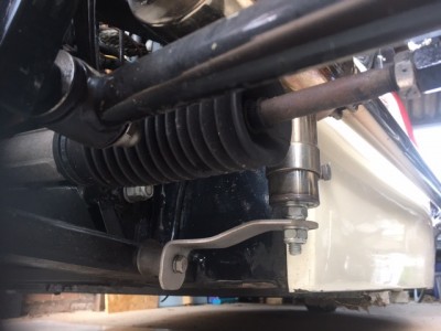

Post by frederick » Thu Dec 10, 2020 2:21 am
This what i did (t4) ...pipes factory length, “p” clamp is rubber mounted with 2-3/8" bolts and extra wide fender washers inside body. The clamps secure 13” stainless resonators. Sound is glorious, not overwhelming aurally or visually. Everything tight...braided couplers allow movement without rattling or pipes drooping.

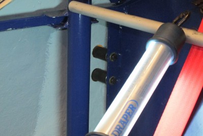

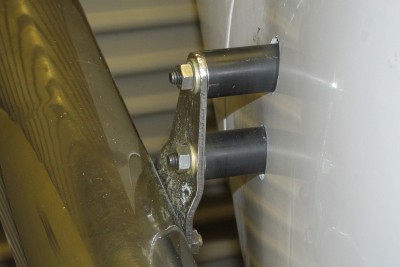

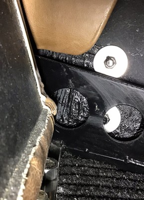

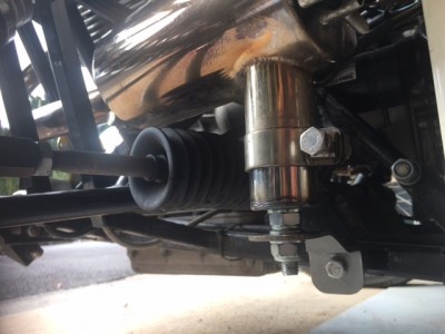

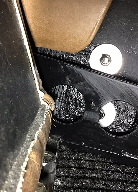

I made up a pair of pillars to carry isolastic mounts. Then I attached the original bike silencers but was disappointed to find that the silencers were too heavy. I had chosen quite hard grade mounts but even so the silencers flobbled (a technical term) around on them. This wobbly mounting would actually introduce vibration, not reduce it. So the idea was rejected.
Instead I have made up simple spacers and long bolts onto the original silencer mounting brackets. This gives a good solid attachment and looks neat.
Attaching in the usual place the double mounting might be a bit over-engineering, but the isolastic system called for two so I had cut holes in the bodywork. So I have two mounts regardless. ;)
Exhaust mount external view
I will be using nylock nuts on the final version to avoid littering the highway.
Exhaust mount internal view
