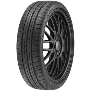

Post by frederick » Fri Feb 14, 2020 8:37 pm
not on the ground yet but here in the US for my T4 with the stock norge rim I found this made in Indonesia: 175/55 R17 Achilles (oddly inappropriate name) ATR-K Economist ... $57 plus ship
https://www.tires-easy.com/175-55-17/ac ... /MAN175517

Post by EricStarmer » Sat Feb 15, 2020 1:21 am
Thank you everyone for your inputs . Richard - the Toyo tyres don't appear to be available over here. Frederick - 175's won't fit between my swing arms - 165's would have virtually no clearance either, so will probably get one of these https://www.cokertire.com/155r15-firest ... -tire.html
