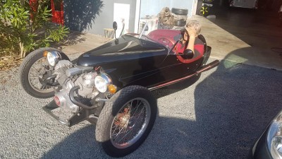

Trikingistas,
The following has come in from a new owner in France: Dominique Chudzik. Like me he uses Google Translate; who can help him please? His looks like a T1 withT2 body.
I don't think he is on here but he is on Triking Owners Club on Facebook and I am conversing with him via trikingowners @gmail.com [no space].
Hello Richard,
Do you have any documentation concerning the 1000 Triking with a FORD gearbox ???
Can you also give me the tire mark before the best fit and the recommended pressure.
Thank you very much cordially
Dominique Chudzik
