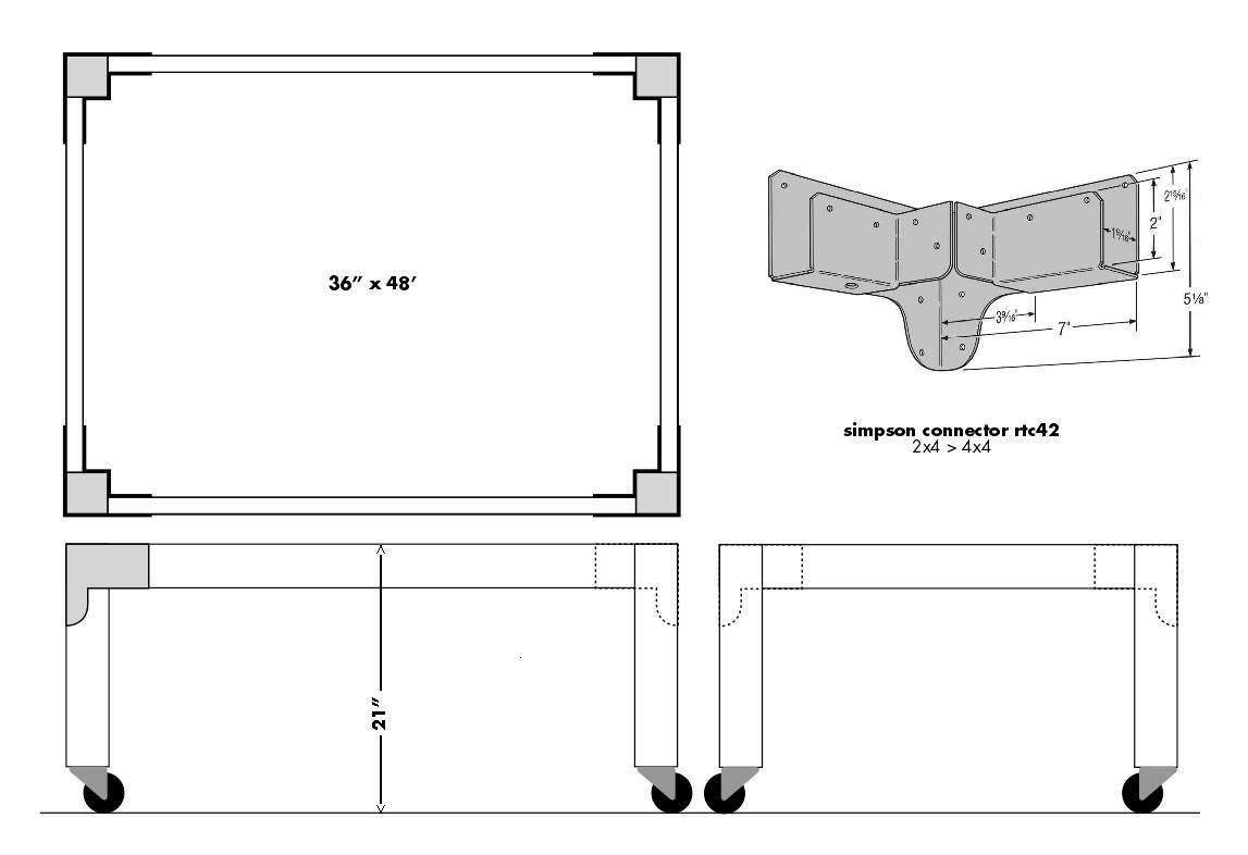

Was asked about mine, here’s what I did...
Wheels are critical, don't cheap out...they need to be big enough to roll over garage floor irregularities AND support at least 25% of the 900lbs-ish / 408kg finished weight. You will need to have some 1 x _ blocking incorporated or standing by to suspend the chassis off the cradle to allow finessing the body shell lips under the outside frame rails. I have 2—1" x 4" x 5' running front to back spreading out the load.
