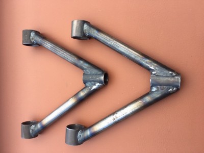

New poly bush type top wishbones arrived this week from Alan. Although the adjustable rose joint is probably the best option, Alan has produced a simpler wishbone which allows for camber and caster adjustment, and keeping inline with the Triking philosophy of “Driving at it’s most elemental” this wishbone fits the bill.
Just waiting to pick up from the powder coaters and to do the final fit.
PS. The photo seems to depict one wishbone larger that the the other, it’s an optical illusion 🥴

by EricStarmer » Sat May 11, 2019 8:47 pm
When the car turns out to be wider on one side than the other, and you keep hitting the kerb, assume it's an optical illusion

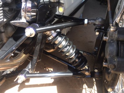

Top poly bush type wishbones now powder coated and fitted. Difficult to find a base to exactly flat to adjust the caster angle, but after working out the base angle I managed to set around 4 degrees and testing it on the road it feels about right, and more and the steering gets stiffer although the steering centring improves.
Job done, now to enjoy the summer

by Weg » Tue May 14, 2019 4:54 pm
Looking good.
Don't forget to check the tracking after 100mls or so.
Have fun.
