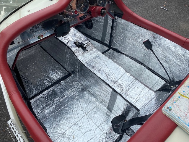

I’ve not had the problem you’ve described; however, it didn’t stop me from sound deadening the chassis, well had to do something during lockdown 🥴😉
