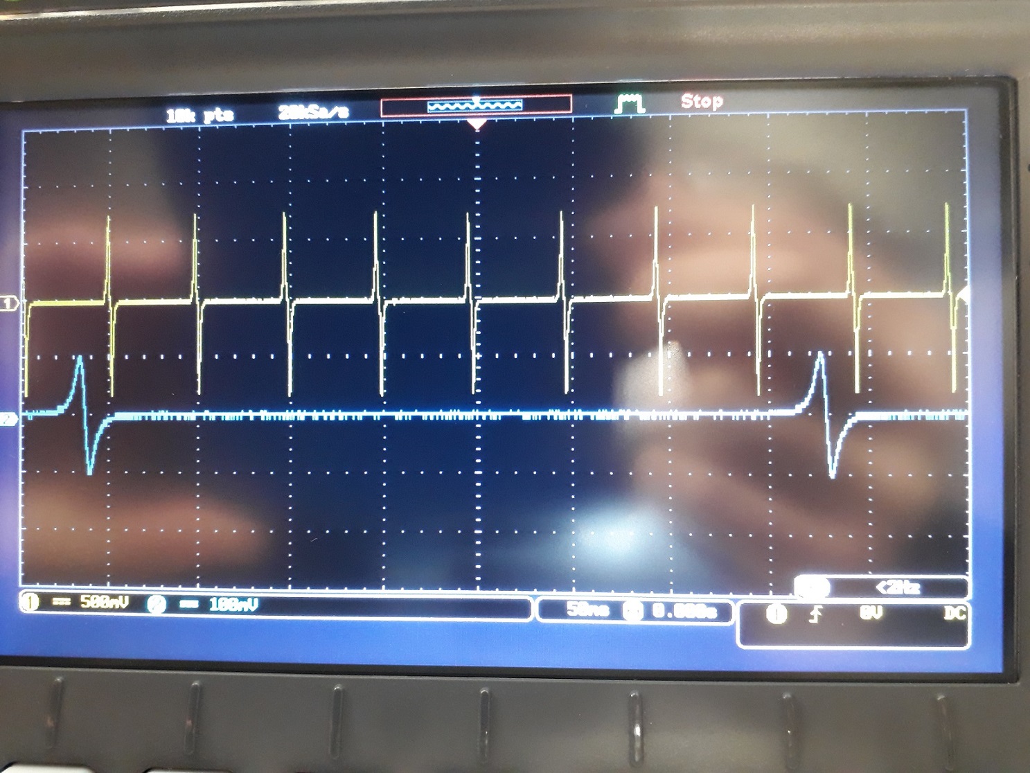

Below is the oscilloscope screen when I was testing the crank and cam sensors.
Yellow trace crankshaft. Blue trace camshaft.
Flywheel has 4 lugs and the cam has one. The cam goes round at half engine speed. The cam one only generates 100mV - not much at all. The sensors are the same but it makes less signal because of the lower speed of the lug passing the sensor.
