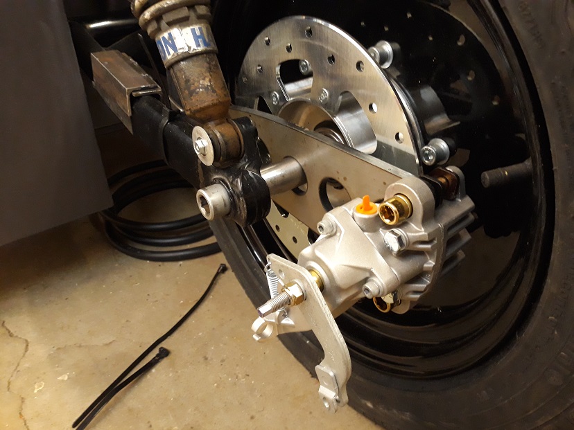

Our lathe is built for wood but can be persuaded to deal with metal too. Here for polishing a bit of pipe for the outer spacer for the rear axle. Is this correctly mounted? The brake plate is resting on the outer spacer. It looks the same as others to me. Do i need to restrain it sideways too? I am building a stopper so it can't start turning when i brake but it can wiggle about a little bit sideways. Is that all right?
