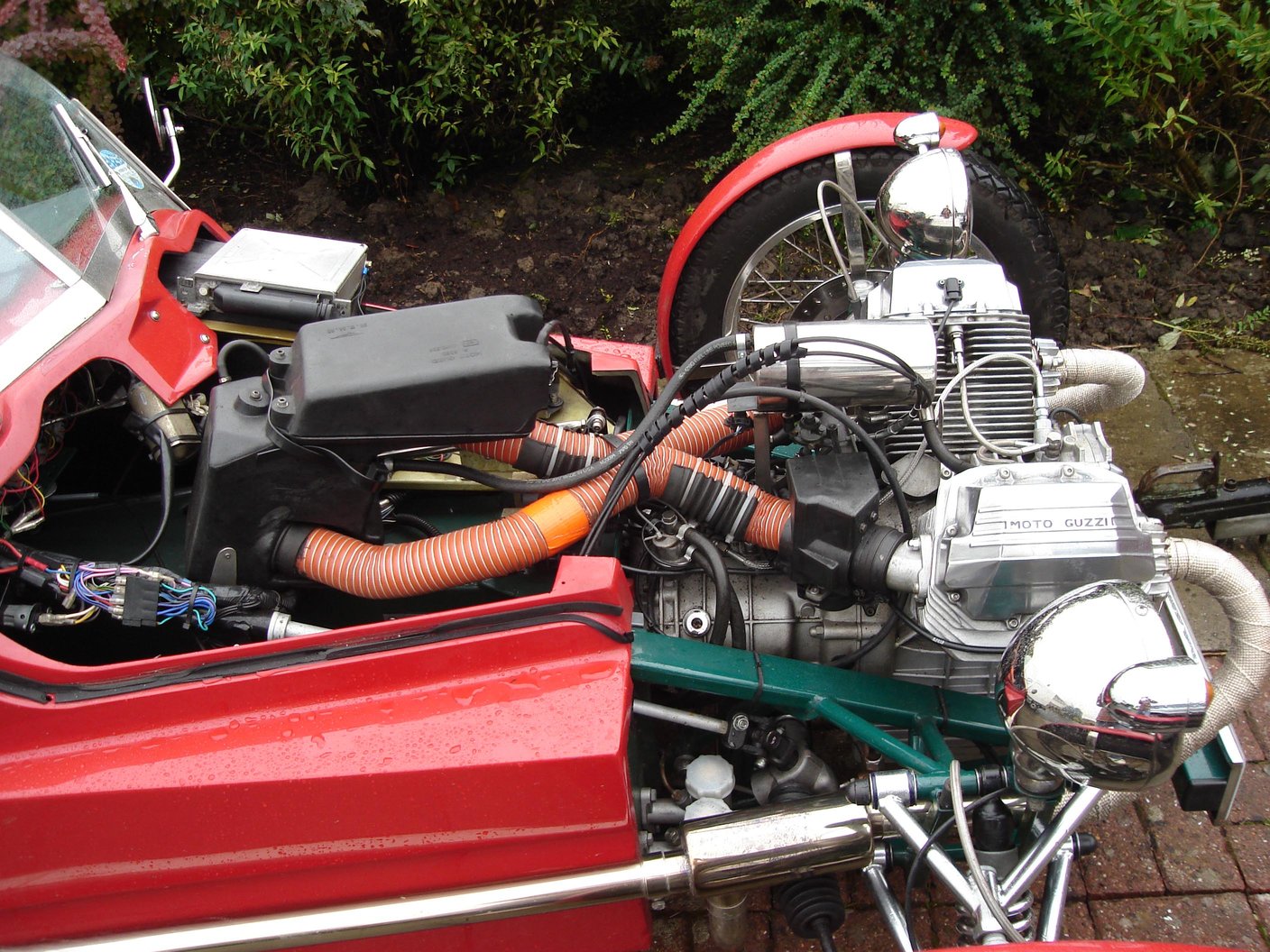

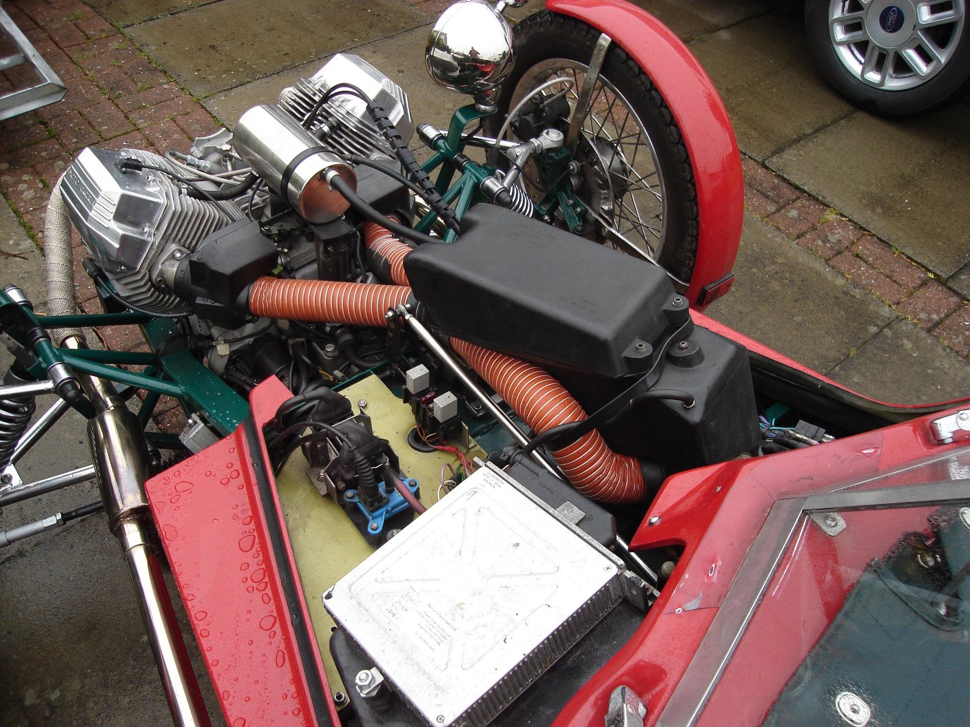

I found the pictures of the standard air box used in a Triking. I have no idea who's car it is I'm afraid. The picture was very useful as it helped me to decide against this installation as it uses so much valuable space the way I want to use it.
In addition I chose not to cover in above the passenger foot well as I have mounted my battery in the front and need access to it.
All the best. Richard

Funny, those pictures did the same for me. (No offence meant to the builder, we jus have different goals)Richard and Pat wrote: ↑Fri May 22, 2020 7:11 amI found the pictures of the standard air box used in a Triking. I have no idea who's car it is I'm afraid. The picture was very useful as it helped me I decide against this installation as it uses so much valuable space the way I want to use it.
I want as much space as possible for luggage and if i do build an airbox it will have use the available space better. The same goes for where the electrics will be mounted, its a balance between protection, ease of maintanance and storage space. I'am very happy for all the pictures both here on the forum and in the groups on facebook. The Morgan m3w uses the available space quite bad, they seem to be focused around cost of production and good looks on the surface.

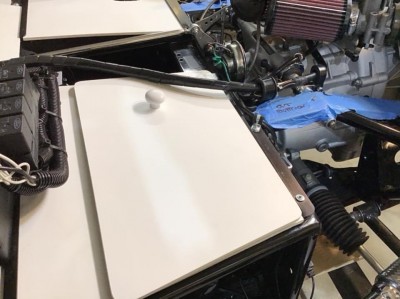

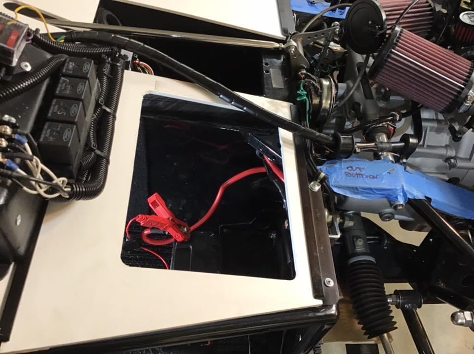

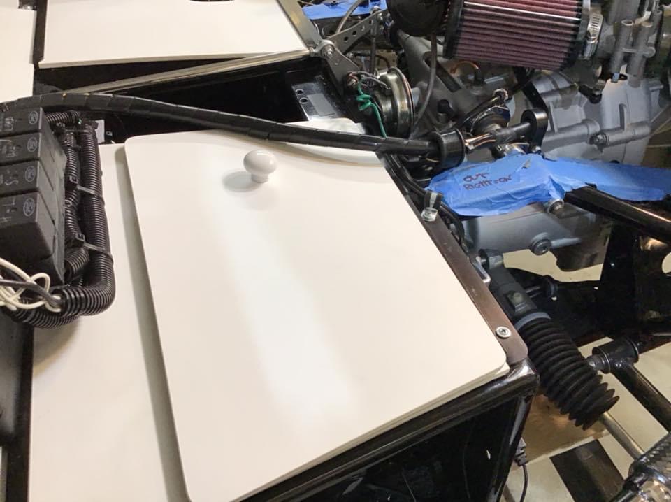

For footwell battery access I made a fixed “frame” and removable panel to keep the breeze out...Velcro holds it in place. Material is .25” pvc sign board.

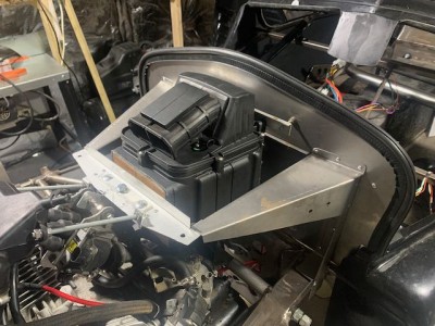

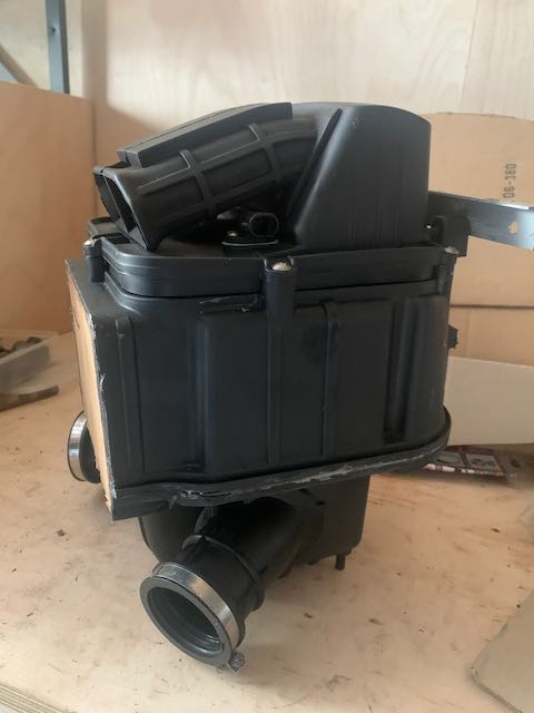

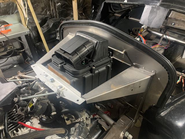

Hi there, the aims for your build seem similar to my own so even though mine is a type 4 may be useful to see these photos of where I've got to so far.
I've modified the standard air intake and mounted the coils in the space this saves behind the alternator (similar to Frederick). The extrusions from the bulkhead hide the wiring for which I've created a bespoke loom so that all the sensors on the left are fed from the left side of the air intake and similarly on the right side. They also serve as mountings for the two-tone horns my brother got me for my 50th off a Rolls Silver Shadow. The fuses, relays and ECU are mounted just behind the bulkhead (occupant side with the battery in the transmission tunnel. This means the area above tunnel to the underside of the bonnet is completely empty.
If I can help with any specifics please let me know

You can certainly see the extra room in the T4.
Re: Build tread (kind of)
Colin, good work with the 'firewall' and air box position.
