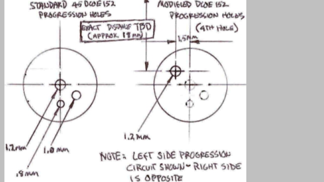

Hi Tony, recently carried out this mod on my Weber DCOE (see pic) fitted a 130 main jet and a 50f8 idle jet and the engine now seems to run perfectly. The length of the inlet manifold still makes the throttle response a little lazy but the engine torque is quite good.
