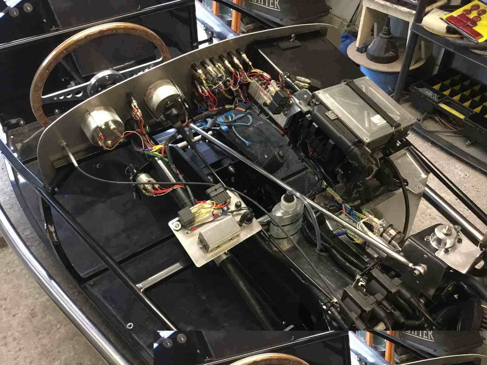

Looks good from here. Hope you've recorded all the relays and fuses on your wiring diagram, not that she's going to break down!
Will the relays on the glovebox be under the body shell?
What is the clear plastic bottle for?
Good pictures that can be zoomed in, thank you.

Hi, yes the relays on the glove box will be covered by body but should be able to remove them, if necessary, by taking off Ecu first. Won’t be easy but hopefully will not need to replace. Have noted what all the fuses and relays are for - didn’t do it when I built JZR and caused a few problems. The clear plastic bottle is the breather/oil expansion for the reverse gearbox, seemed a suitable place to put it.

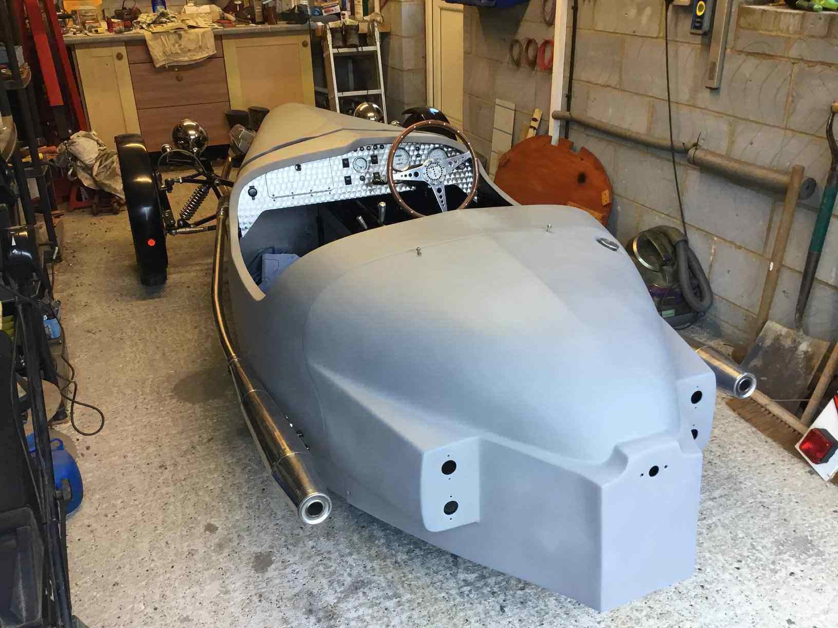

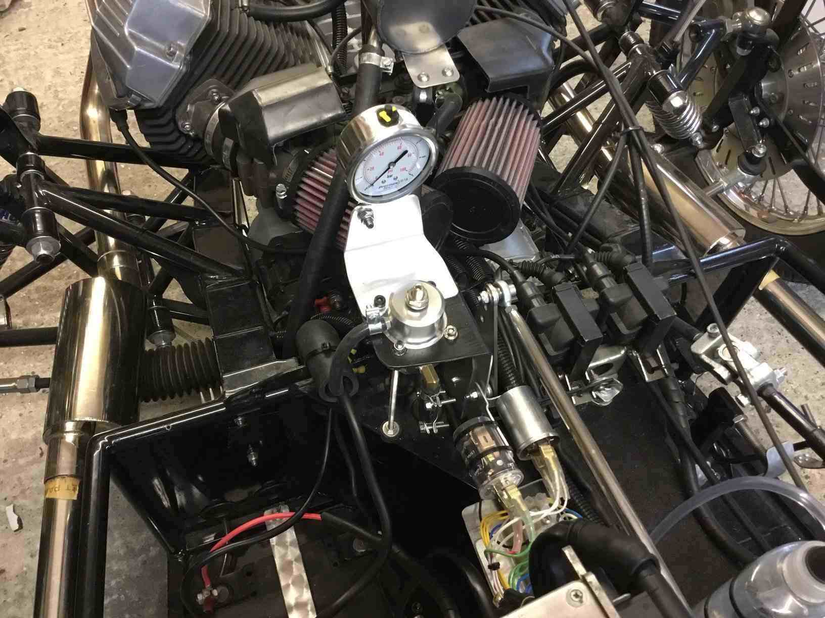

Things have slowed down due to weather and laziness! Body is in shed, all rubbed down ready for lots of filling and making good. Don’t enjoy this so doing little bit at a time. Finally got fuel pressure constant by fitting new regulator from Alan, using liquid filled gauge that I already had. Have also repositioned relays, as previously said by Westendguzzi they were hard to get to and the body actually just hit one.

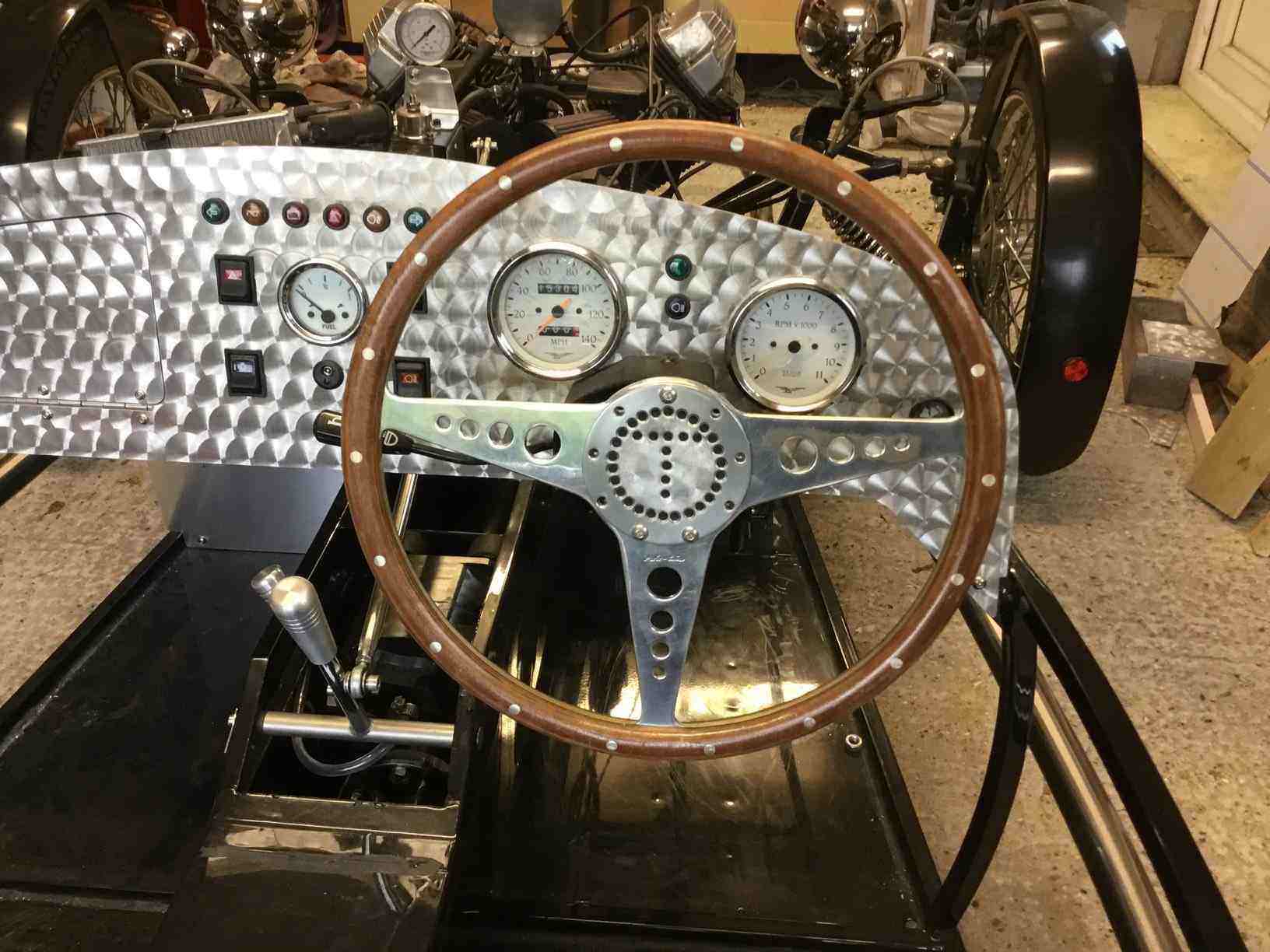

Got a really lucky buy last week. One evening, nothing much on tv, so browsing on iPad and decided to look for wood rim steering wheel. No “bargains” on eBay or Gumtree but on Preloved was Moto Lita 14” wheel for £24 ovno, approx 35 miles away. The seller said it had never been used but was many years old and had some storage marks on wood. Paid £22 and picked up the next day, made an adaptor plate and now fitted to q/r boss. Looks much better than the leather rim wheel I was going to use.

Well done. Will you blow the body over with a guide coat to highlight the pin holes? I wish I had, also should have used fine stopper. Final coat going on next month now pin hole work completed.

Planning to give whole body a coat of etch primer as this seems best way to highlight pin holes. Did a trial area of approx 2 square feet and found 6 pin holes. Once entirely done in etch primer will use fine filler and then a coat of primer. Am hopeful that I have now found a local car body shop who are happy to apply colour coat and clear coat for around £500 if I do the preparation. Since the weather is now too cold and damp for me to spray with aerosols in my shed/workshop, I either pay up or wait for 6 months for better weather. Either way, have now decided that body will be painted before fitting.

Leisurely progress, but have finally got body ready for paint. The process of filling then rubbing down has been repeated many times but have now applied an etch primer followed by a primer/filler and am quite pleased with the finish. Have also found a local spray shop who will apply the top coat and clear coat at reasonable cost - should be done early Jan. Was going to paint it myself with aerosols but would have to wait for much warmer weather and would not get such a good finish.
