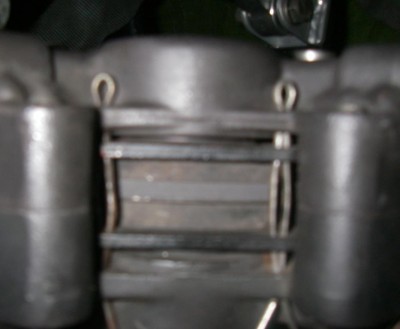

by Oleg » Fri Jul 12, 2019 11:04 am
Ivan
Rattle is healthy but I agree is annoying. Richards pads system will certainly help in a similar way to shimming however my solution is:
Make sure the caliper is set centrally to the disc, use copper grease on the back of the pads and after fitting bow out the split pins to reduce for and aft float. In the picture it looks like the caliper is not central but it is.
