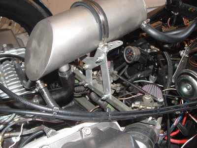

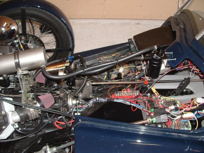

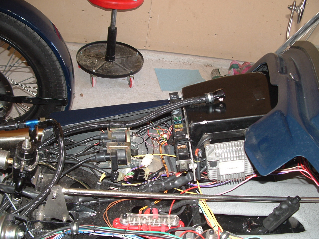

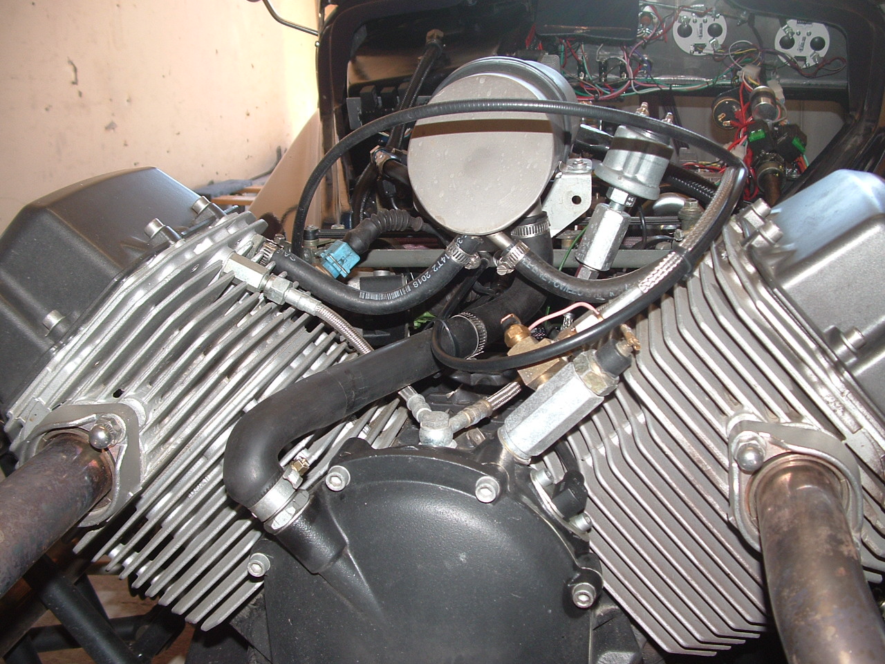

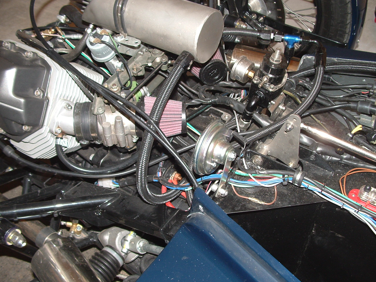

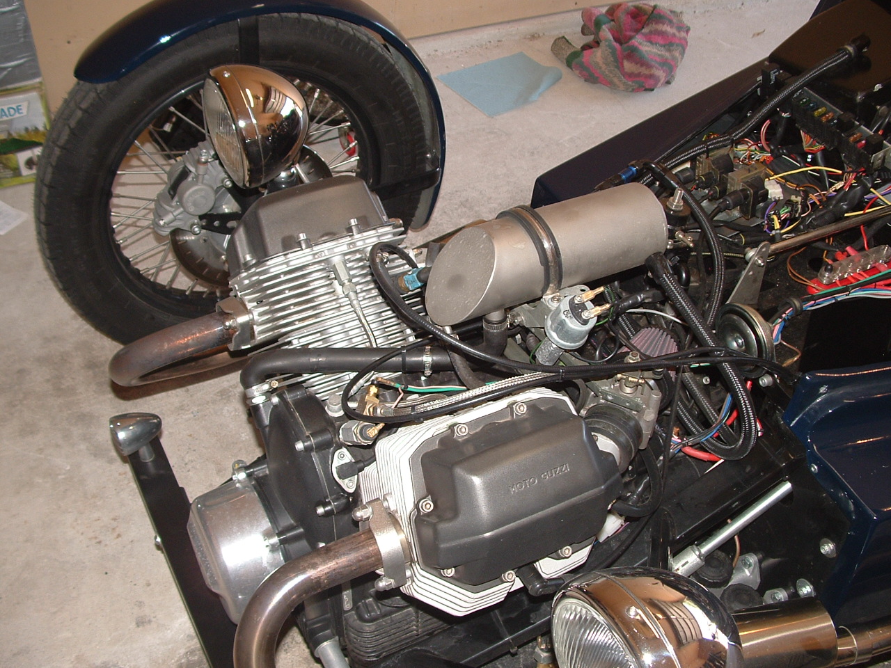

I did sneak out to the garage and got a few pictures of the current arrangement.
The first picture shows the whole arrangement with the return hose clearly visible with the clamp midway along the horizontal section.
The second picture is a frontal view. The hose actually tilts slightly down as it runs to the back before the bend up to the breather/condenser tank.

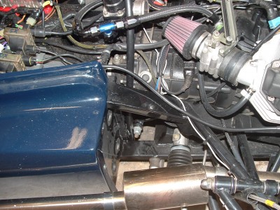

The third picture shows the hose off the back of the tank looping down to cross the back of the engine.

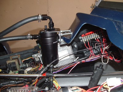

The fourth picture then shows the hose leading to where the final breather filter to atmosphere is mounted. I currently have the actual filter set aside.
The breather/condenser tank does sit completely under the bonnet and there are a couple of inches of clearance to raise the tank if that seems necessary to at least tilt the hose the other way (front lower than back).

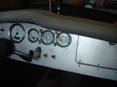

I removed the electrical oil pressure gauge and oil temperature gauge. I replaced them with a voltmeter and a mechanical oil pressure gauge. I also removed the original breather/condenser to troubleshoot the return hose and redo the vent hose arrangement.

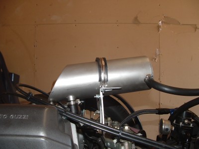

I found the return hose not entirely horizontal. It had a slight downward angle toward the breather/condenser tank which is reverse what it should be according to the responses here. I made a tab to raise the breather tank a bit higher to get the hose angled down to the front of the engine, which also let me tilt the tank nose down slightly to raise the vent port at the back. I also made a stabilizing tab to add more support and stability to the breather tank since it was raised. It took a couple efforts getting the new height set. I tested the return hose for draining back to the engine at the new angle and now it does flow correctly.
I then went ahead and plumbed in a secondary oil catch can being fed from the original breather/condenser's vent port. I routed the lines up higher, without the kind of drop the original vent line had. The secondary catch can has a drain line with a petcock and a vent line to atmosphere that I ran down to the right front corner of the tub so that it will not put oil/vapor into the passenger footwell like before.
