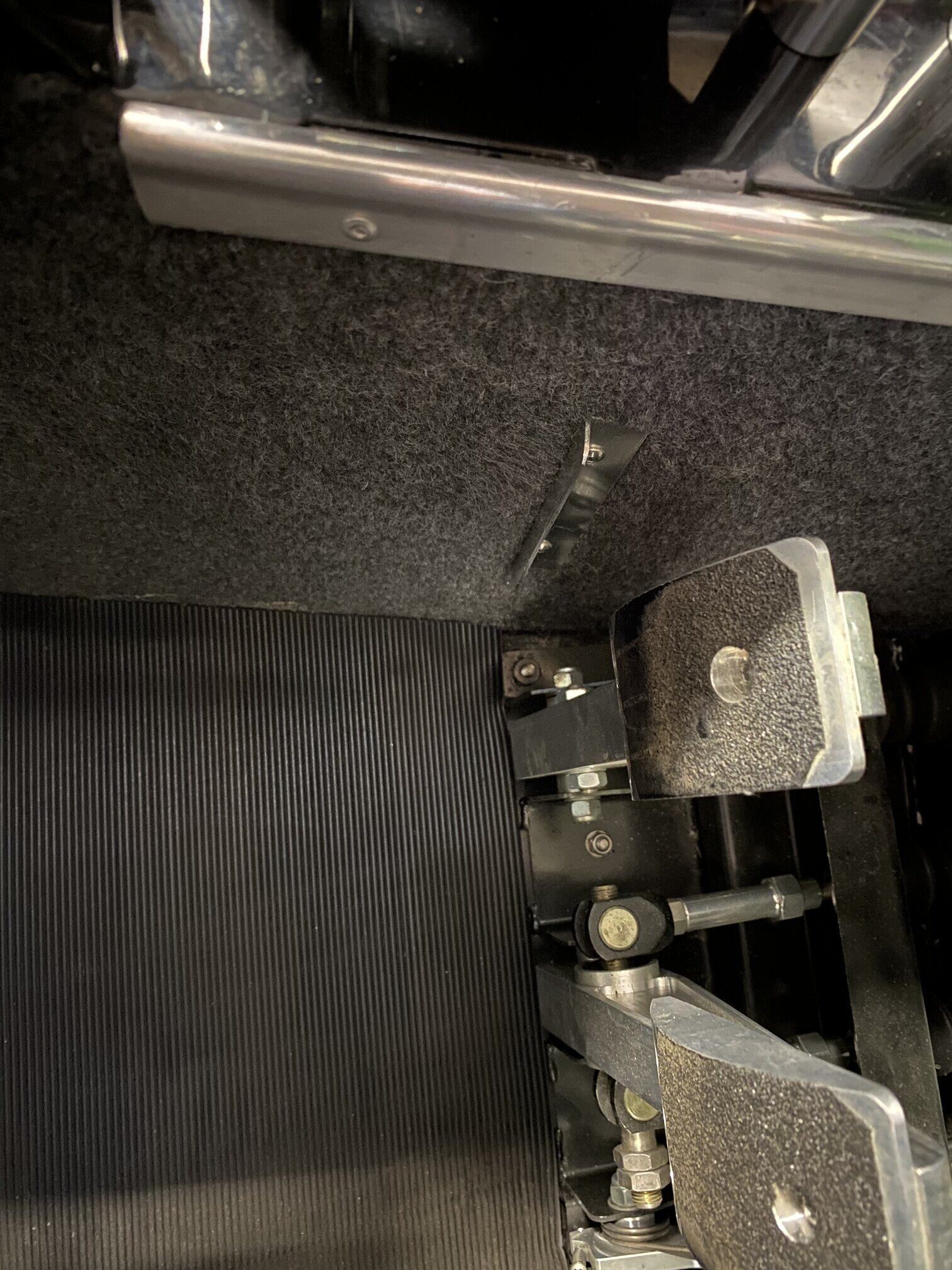

Rune,
Here are the types I have made Large adjustable item on a RHD T3 and the other just a short length of Aluminium angle on a T4
I was thinking for LHD you could stick a couple of lengths of 5mm x 12mm Aluminium strip to the body sides vertically having first countersunk and tapped M4 with the remainder of the M4 bolts sticking out then the Mk 1 style could be bolted on in the suitable position?
Re: Tired left foot
The cheap little mod works a treat
