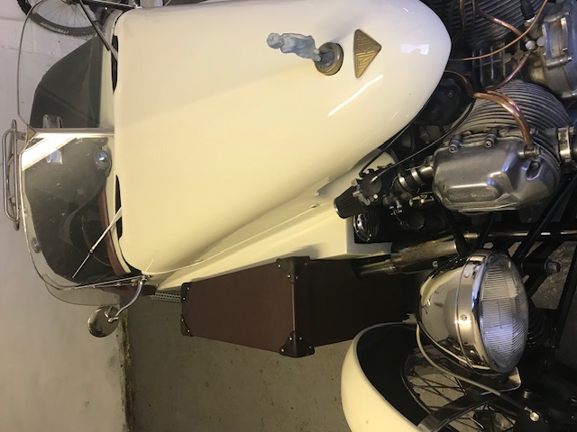

I left the exhaust where they were and reshaped the panniers which are also quick release.

Re: Lowering exhaust for panniers TYPE 1
Post by Musselermark » Thu Dec 12, 2024 3:31 pm
I did the same as Doverhay, having fabricated some from ally sheet. Mounted exhaust wrap on inside of pannier near exhaust but airflow minimises any heat soak.
Musselermark
Posts: 36
Location: Norfolk
Post by Musselermark » Thu Dec 12, 2024 3:34 pm
Pannier
