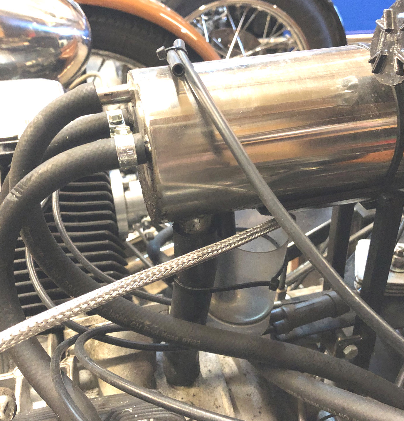

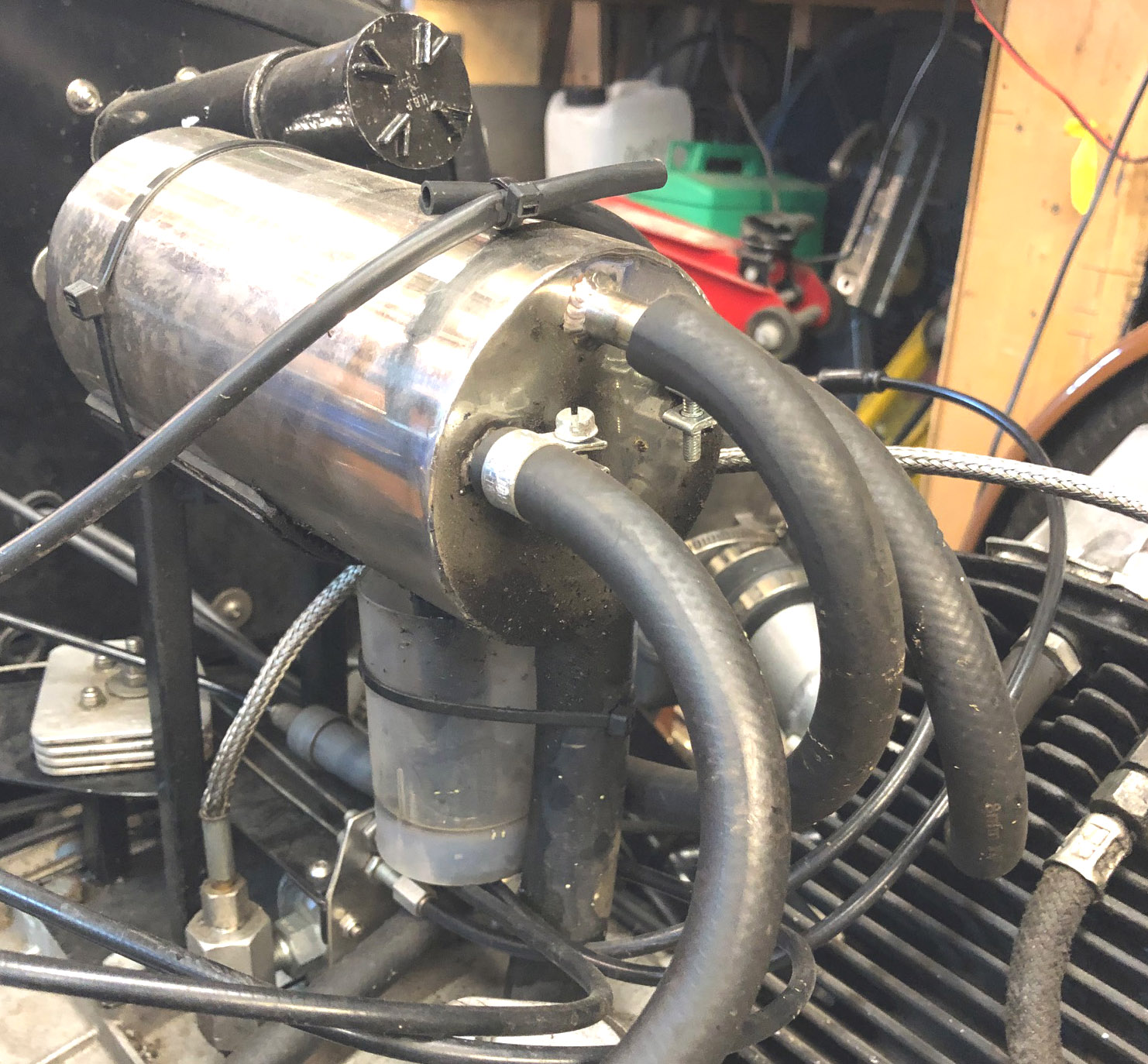

Re: Ventilation diagram for Cali 3 engine/gear year of build 1992
Henk
My engine is about the same age as yours, the vent box is of uncertain parentage, may have been from a T1, may not look anything like yours but principle will be the same. As my carbs are splayed out, I have plenty of room for the box and progressive throttle linkage.
The box sits on the 2 12mm sqare columns welded to curved holder then bolted to gearbox.
The front of the box sits on the crankcase breather, (which encases a large steel ball), breathing out but not in.
Top pipe at the front (no jubilee clip) is vented to ground but never drips.
Middle two pipes at front vent from rocker boxes, no restriction.
Then there is the mystery pipe just behind the crank breather pipe, which I have vented into a small container, cable tied to the crank breather. Not sure how far this pipe protrudes into the box but I do get some oil collected in the container over time.
Gearbox has it's own vent which I loop down to ground, but it never drips.
Not forgetting the reverse gearbox which needs a vent pipe taken up to a higher level with a catch pot. )I put mine on top of the petrol tank). This is essential as it does breathe out oil into the catch pot, which will be syphoned back to the gearbox as it cools provided the vent pipe goes to the botttom of the catch pot.
Hope this helps.
Hi Tony,
Thanks for the pictures and the description of the ventilation.
It surely is a good help
I think my engine breathing system is similar, the only difference is that my collector cylinder
Box is smaller in diameter and the piping from the rocker caps to the breaker are shorter.
I could try some longer hoses.
The reverse gear box breather is mounted inside the tunnel but higher up and with a loop in the piping, I don’t have any leakage from that set up.
I am using the original air filter housing (noise level otherwise to high) on my carbs.
Thanks again Henk

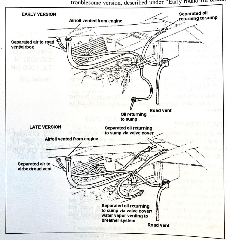

Do you have this type of breather box (or similar but slightly larger aftermarket type)?
Aftermarket (Agostini)
In which case:
The pair out of top= breather pressure from valve covers (fixed to the lower large pipe on Agostini)
Large on bottom = Crankcase pressure in (from block)
Small on bottom next to large = oil drain (condensed back to oil in pan)
Medium on a slant out bottom = outside air/ pressure air out no oil(hopefully)
Another version is this integrated breather...
Which is similar to above except the rockerbox breathers are connected lower down and the air pressure out pipe is fed directly into the intake plenum, after the filter.
The Cali 3 uses the frame as the breather box. Crankcase pressure is fed into the frame, oil is separated and drained back into the sump. Rocker feeds, if there are any, I think are fed into the air filter plenum as is the pressure vent from the frame. Sorry, can't find a decent illustration of this one.
So, essentially the breather system uses different components in each case, but serves the same function:
- a one-way valve lets pressurised oil mist out of the crankcase
- this enters an oil separator box, where the oil condenses out
- condensed oil runs down a pipe into the sump, below the level of the oil
- separated air is vented from the separator box; this is sometimes dumped overboard, sometimes recirculated to the intake tract
- sometimes vent tubes from the rockerboxes are fed into the separator box (and sometimes into the air filter, and sometimes into the crank vent pipe)
- sometimes the separator box features a non-return valve on the vented air outlet to prevent cold, damp air being drawn into the separator box
I've not managed to get to my Guzziology yet, but it is still on the list!
In which case:
Henk, finally I got to it...
as a '92, yours is the lower image.
What I didn't realise is that the return oil path on your model is via the rockerbox breather pipes, rather than directly to the sump.
- Posts: 38
- Joined: Thu Jan 20, 2022 10:13 am
- Location: Netherlands
Thanks, that’s it, good info.
Now I can reroute the hoses in the correct way, great help.
Henk
Henk

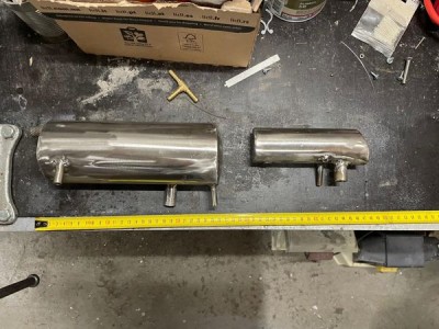

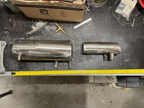

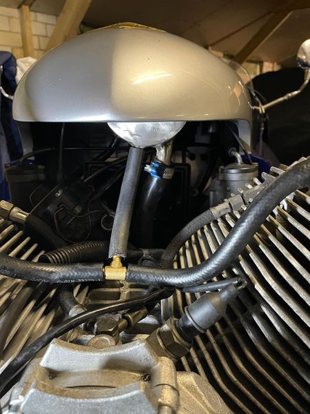

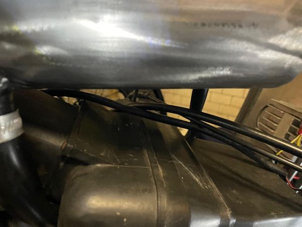

Hello Triking owners,
I have made my engine breather myself, from Stainless steel pipe.
It throws out a minor amount of engine oil, mainly o few drips after a long tour(200 km+/120 miles)
Some leaked on the engine which leaves a filthy oil stains, and on the car trailers floor.
Now I have changed the volume of the container from 293ccm to a bigger 1133ccm.
I also moved the container under the nose cone of the bodywork.
Thanks to the diagram I also changed the connection arrangement of the hoses as it almost was on the motorcycle frame before I mounted the engine in my type 3 Triking.
So far no oil drip problems.
I also pleased with the clean V-2 look between the cilinders.
The lesson I learned(that is always the fun with the Triking) if you manufacture a breather holding tank make it more than 100% of the engine capacity.
I have a California 3 946ccm , so now with the 1133ccm (120%)capacity I am confident that the oil drip problem will at least be over.
Happy Triking
