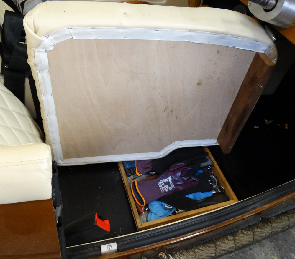

A piece of wood a couple of inches thick screwed to the front edge of the seat raises it up to give a lot better comfort. Space underneath for a tapered tool tray. Pics and dims to follow soon. Watch this space.
Posts: 941
Re: Front wheel removal
Post by Weg » Thu Jan 18, 2024 10:32 am
My seat base is 550mm long so oversails the chassis rail, 2" riser tucks in behind the rail keeping the seat in position. Much better support for the legs giving superior creature comfort on long runs.
Hence space for tools.
