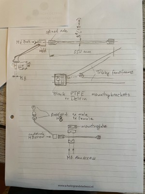

Hi all,
It took some time to have the plans ready for the Anti Roll bar, but here it is.
I was in spired to see if I could fit an anti roll bar to my Triking type3, by this picture of a wide front ended Triking racer(?)
I made some rough sketches, but realized that fitting the torsion bar throu the box sections on the front frame would be a problem.
So I made a torsion bar from a splined axle and turned the midsection down to 1/2” or 12mm
The splined ends wil take the arm that will be attached to the lower mounting point of the front shocks.
The mounting brackets for the torsion bar are made out of Delrin (or PTFE) and mount inside the boxed sections on the front frame.
I have some photo’s and drawings but I am sorry to say I can’t post them in this post.
Hope to have them soon up.
I am finishing the whole assembly this weekend and let you know how it altered the handling of the car.
Henk
Henk

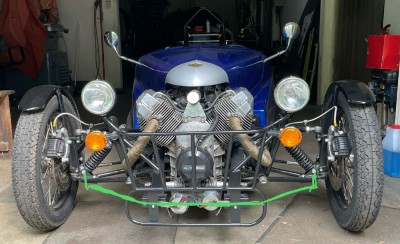

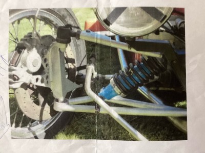

On replay to the pictures above.
Thanks Tony for summiting them,
The lowest(last) picture shows the idea and inspiration to get a anti roll bar on my type 3
The one above that is how I would vision the anti roll bar on my type 3.
Then the arm(s) with the rose joints and the stubbed M10x1,0 mm nut with M8 threaded stub , to hold the lower shock mount and to hold the Rose joint from the arm of the arm.
Then you have the first rough drawing for the anti roll bar and finally the worked out plan to manufacture the anti roll bar.
Bear in mind that it is what I have made for my Triking type 3, it can always vary depending upon each individual choice.
Hope this explanes a bit, I will have a update later with some better pictures
Henk
