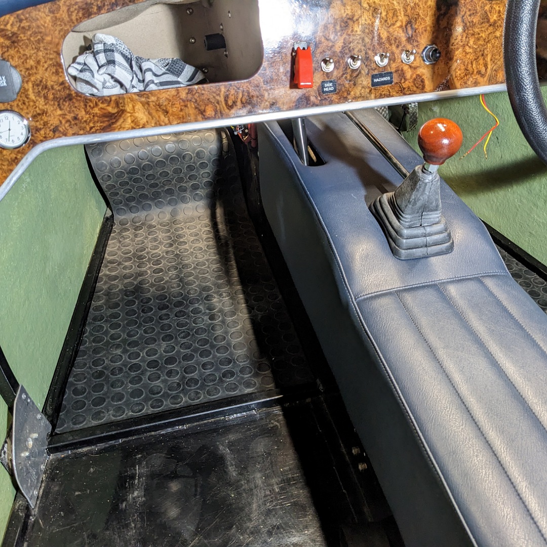

Let's try and attach a pic of my custom gear selector gator......
