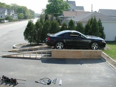

Pretty simple/cheap, but you'd need 3 ramps and (shorter) boxes.

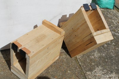

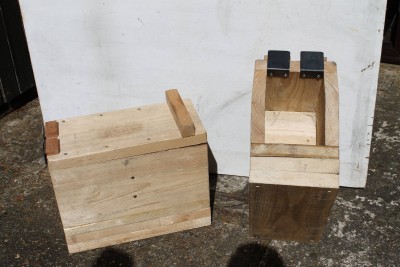

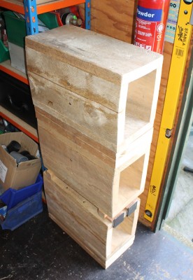

I made some boxes out of Scaffold planks with a clip on the front for my 'Bike' loading ramps to fit into and I push Squeaker up onto the front two boxes. Rear is then jacked using the box section in front of the rear wheel until I can get third box under wheel. Andrew F made his boxes out of a sheet of ply and a little taller. He is home shortly and I will ask his dimensions. Mine are 14" H x 18.1/2" L x standard Scaffold board 8.1/2".

Easy storage, two heights and uses ramps already owned for trailer.

Thanks for the detailed description/photos , Richard - the photo I posted wasn't of a car of mine, found it on the Internet - seemed a good way to go - I do it pretty much the same way as Tony, alternately jacking the front and rear, and putting concrete blocks under each end as I go.

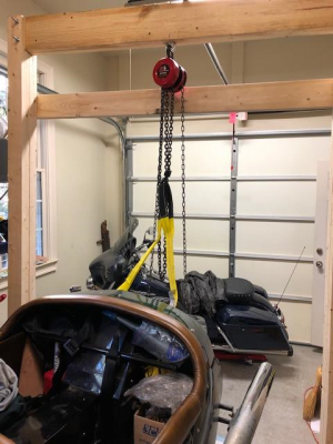

Post by bdaughdrill » Mon Dec 24, 2018 3:27 pm

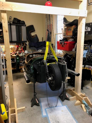

Never underestimate a person with timber-framing in his background. Since there is no access to the attic above the garage to bolster the existing joists, I framed a 1500lb rated frame and stand for an engine chain hoist...the Green Beast is happily up off the floor sitting on a wooden frame sitting on 6-ton jack stands. I'll leave the hoist in place as "insurance" should something decide to let go but we have liftage….
