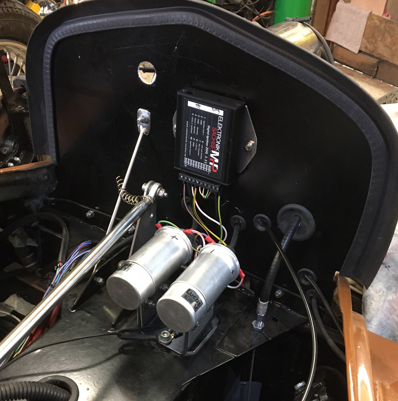

I've replaced the Digiplex electronic ignition system on Clarissa with Elektronik Saches, same as fitted to my previous builds.
Wow ---- Transformation.

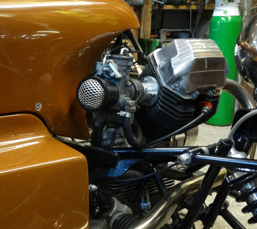

It's been pointed out to me by Mussellermark, who has first hand experience of under-bonnet fire, the perils of backfire possibly caused by wasted spark ignition.
I may have inadvertently, in the eearly design stage, minimised the risk with out-splayed carbs.

Post by Spaniard » Sat Jul 15, 2023 5:24 pm
Where did you source the weather stripping attached to the firewall? That looks like it makes a good seal.
Posts: 919
Re: Digiplex V Elektronik Saches
Post by Weg » Sat Jul 15, 2023 7:41 pm
I sourced this from ebay
https://www.ebay.co.uk/itm/122843171771
It did need warming (hotting) up with the hot air gun to get it to follow curve.
Easiest to do this job with engine removed so you can see what you are doing under bonnet.
