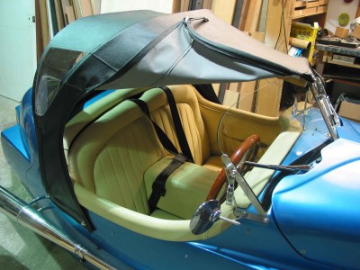

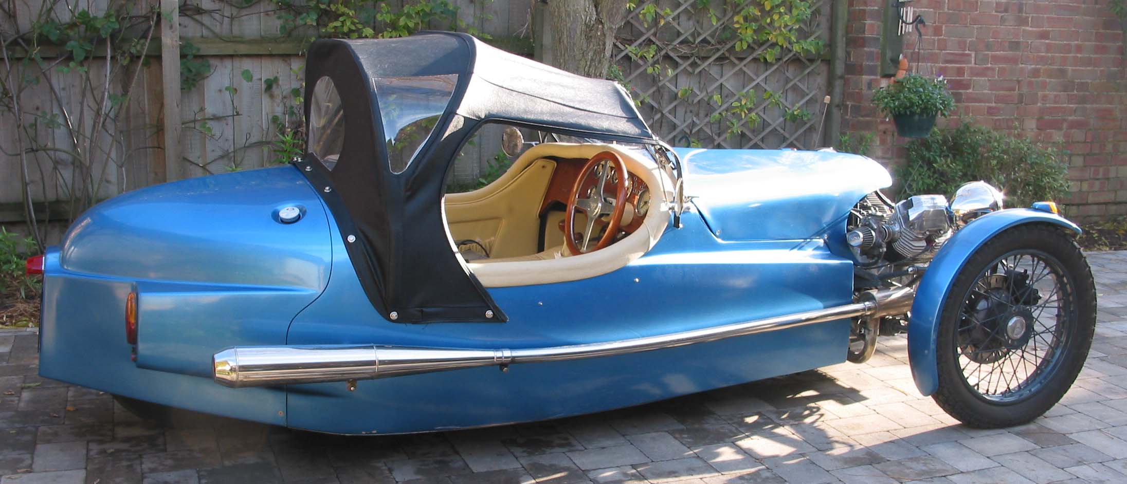

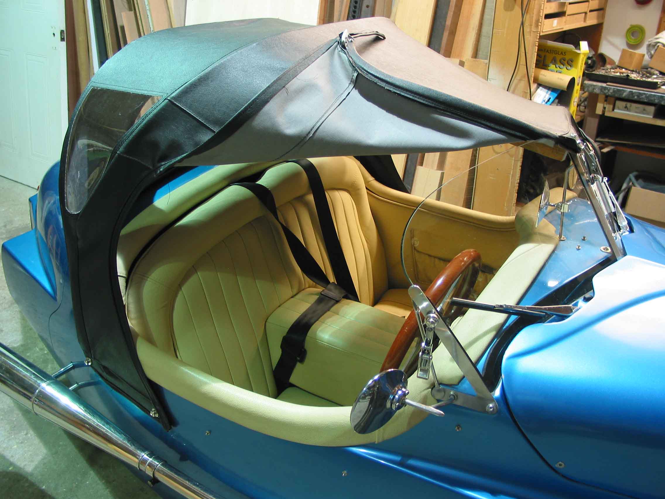

I've made 3 hoods on this princple.
Double hoops which hinge together and plug into a sockets bolted on the outside of the body.
Fastened and tensioned at the front with 3 overcentre clips.
The hoops split in the centre and it all folds down into 2 zipped bags to stow away behind the seats.
