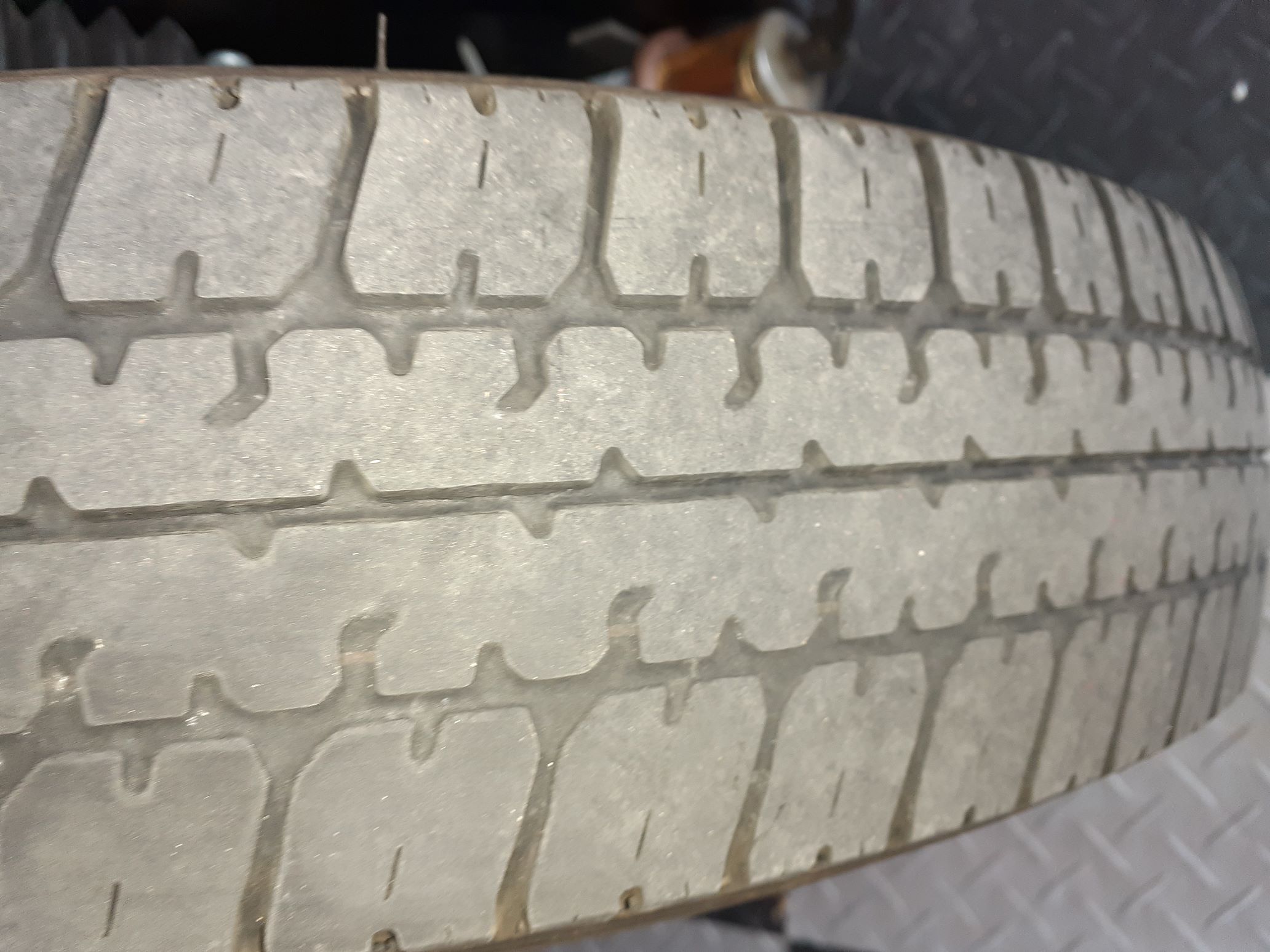

Post by steveO » Sun Jun 11, 2023 9:54 pm
Hi,
I think the photo attached.
Left side of tire worn more than right, as looking from rear.
Readjusted swing arm bearings to day, but really did not need.

Post by Weg » Mon Jun 12, 2023 8:43 am
My theory is there are more right hand bends on your favourite routes and you are accelerating hard out of roundabouts.
