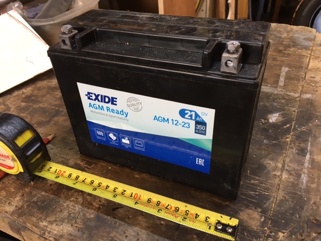

In the UK Halfords sell a Yuasa Garden Battery specifically for kit cars in a useful size however having seen Tony's current build today he has a narrow Excide, I think, I will get more detail. However, for longer battery life connect to a battery saver type charger like Optimate once parked up and these with maintain the battery better than a normal charger.

Post by Weg » Wed Sep 07, 2022 3:53 pm
Available fron Tayna-batteries, found on ebay.
