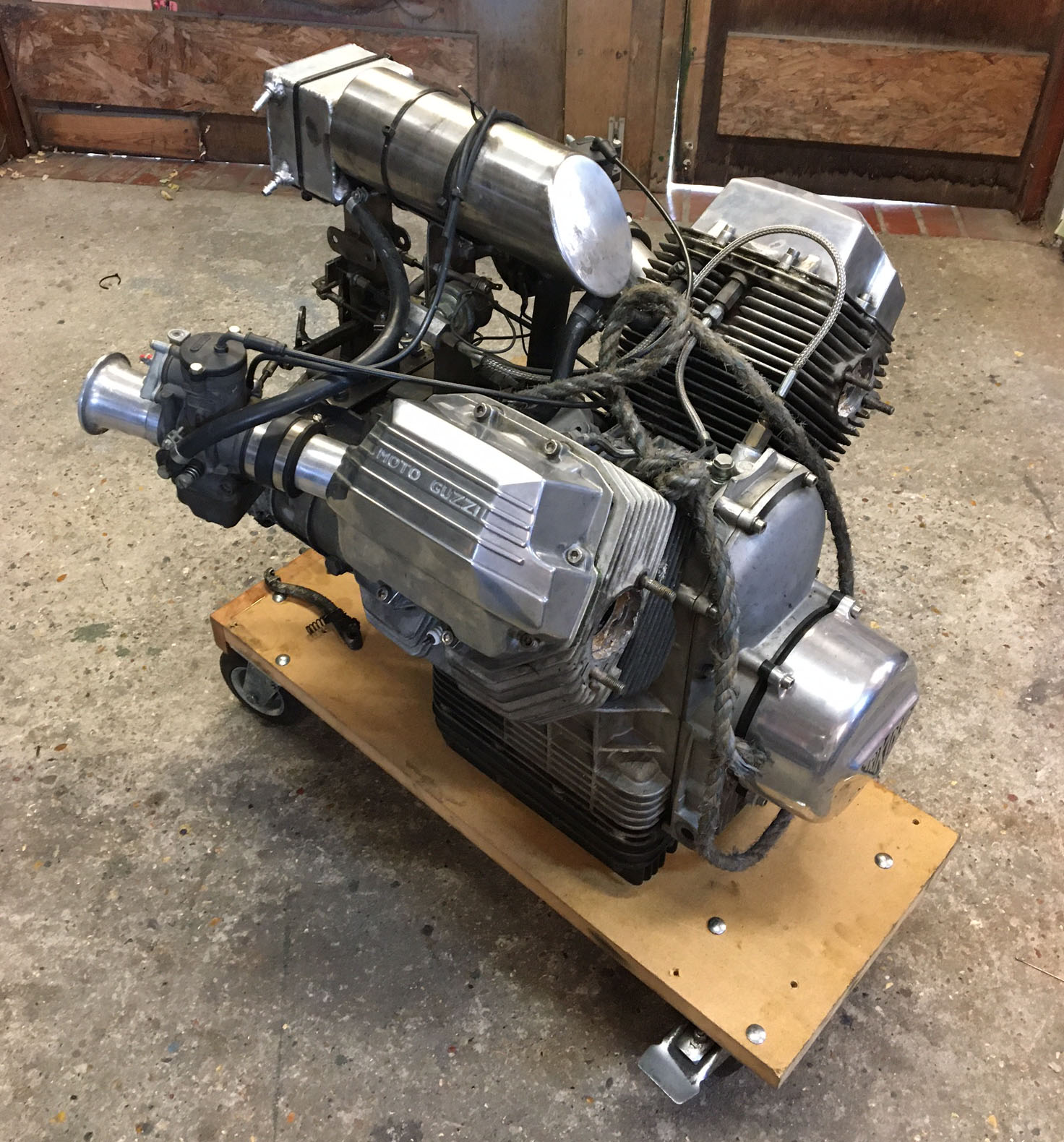

Clutch cable was ok both ends so engine out.
Had to make up a new wheeled dolly as my build-height engine stand is in use.

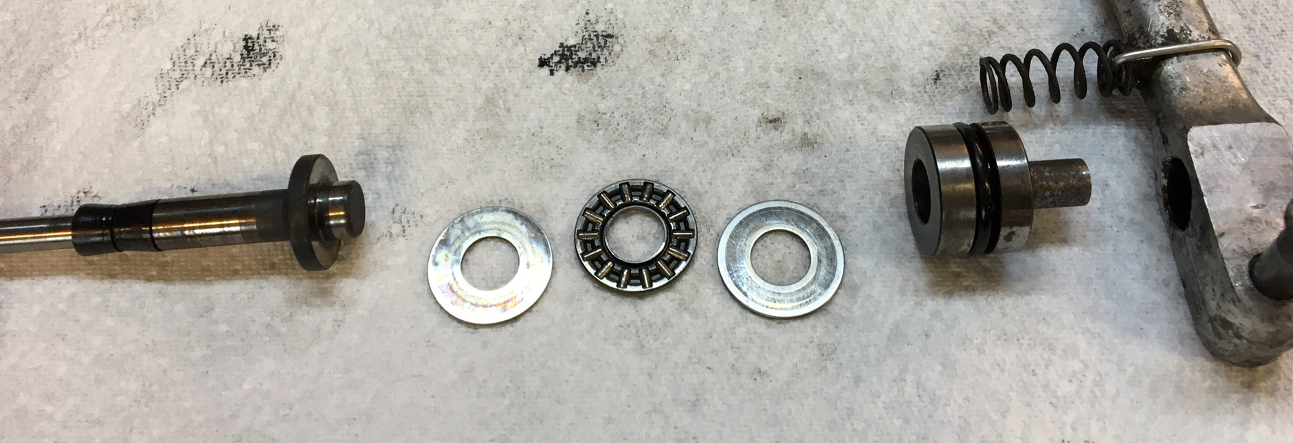

First inspection showed no problem with cable.
Roller thrust bearing looked ok so delve deeper.
Next job is out into the yard for gunk and pressure wash, ready for splitting gearbox from engine.

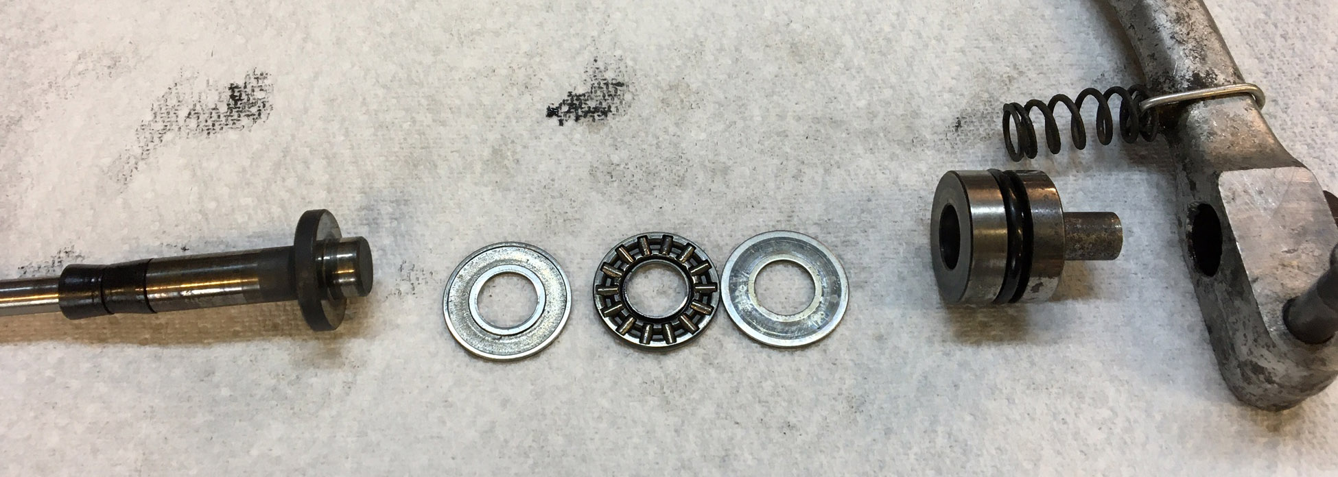

The only obvious wear I can see is on the thrust needle roller, which would hardly throw the adjustment out.
Turned the washers over to present a smooth face to the bearing.
All looking clean at the clutch end with no dust residue.
Put back together, oid change while acccessible, refitted and ready to road test tomorrow.

Great result, well worth the effort.
Clutch now working smoothly. How much was due to the thrust bearing or having greased the cable, I'm not sure.
I'll be getting a new thrust bearing ready for next time the engine comes out.
