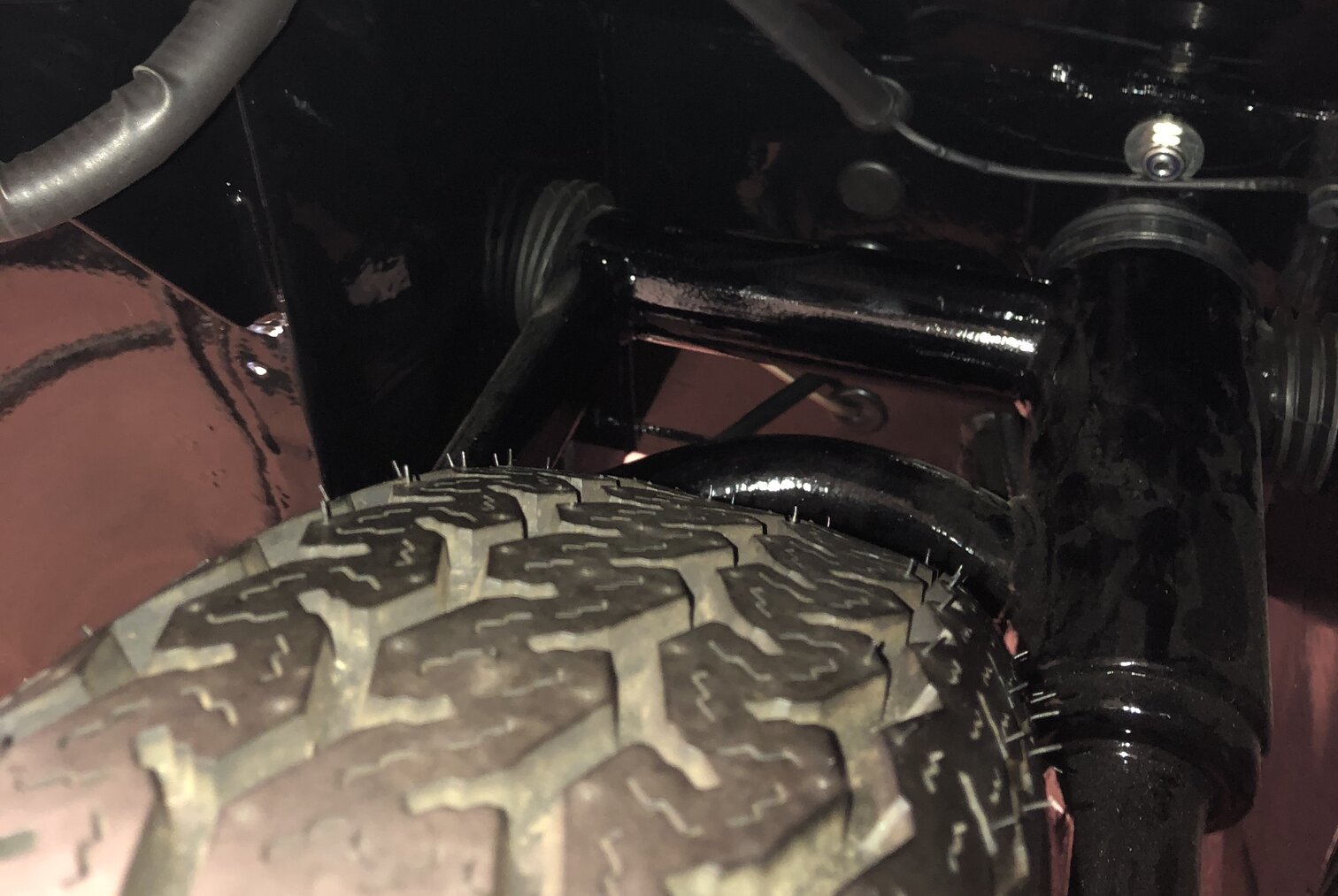

I'm fitting the swing arm to my type 3 and have a dilemma, I'm wondering what others have done? The build guide says:
"It is good practice to fit a dust/debris seal between the std Guzzi swing arm and the Triking chassis to protect any exposed thread or shaft on the swing arm retaining bolts, a suitable seal can be fashioned from a universal type steering rack gator or CV joint boot, if the seal is made slightly over long its natural convoluted design will retain a constant sealing pressure once fitted in place."
As I have only about a 3mm gap each side between the swing arm and the chassis, do I need to protect the threads? If I do, what have people used that won't wear the coating off the chassis as the arm moves up and down?

Re: Swing arm retaining bolts
Thanks Richard, a picture is worth 1000 words. That's what I expected the build guide meant, however I was concerned that the edge touching the chassis would wear the powder coat away. I assume as you have so many years experience with a Triking that you haven't found this an issue? Am I just over-thinking this/paranoid?
Hi Andy,
I don't know about so many years but the softer material IMHO is the gaiter. I haven't stripped out a covered one yet but I have an uncovered one and replaced the bearing as a consequence. Tricky job needing an internal puller. There is not a great deal of movement here either.
