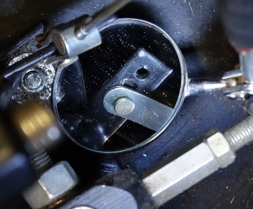

Just to clarify, with help of a mirror, I've moved the hole twice.
