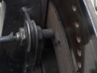

Just having another look at the speedo on my type 3. The speedo has not worked since prior to my ownership. The pick up is on the front disk and I originally thought the proximity sensor would detect the fasteners for the disk. Another automotive enthusiast has suggested there should be a magnet. What do other owners have?Image

Yes, there should be a magnet. Amd the distance between sensor and magnet must be correct. Otherwise you get wrong readings.
Re: Type 3 Speedo
Post by Weg » Fri Jun 17, 2022 9:11 am
It does not have to be magnets.
Polarity is important
2 prefered.
Gap is ctritical.

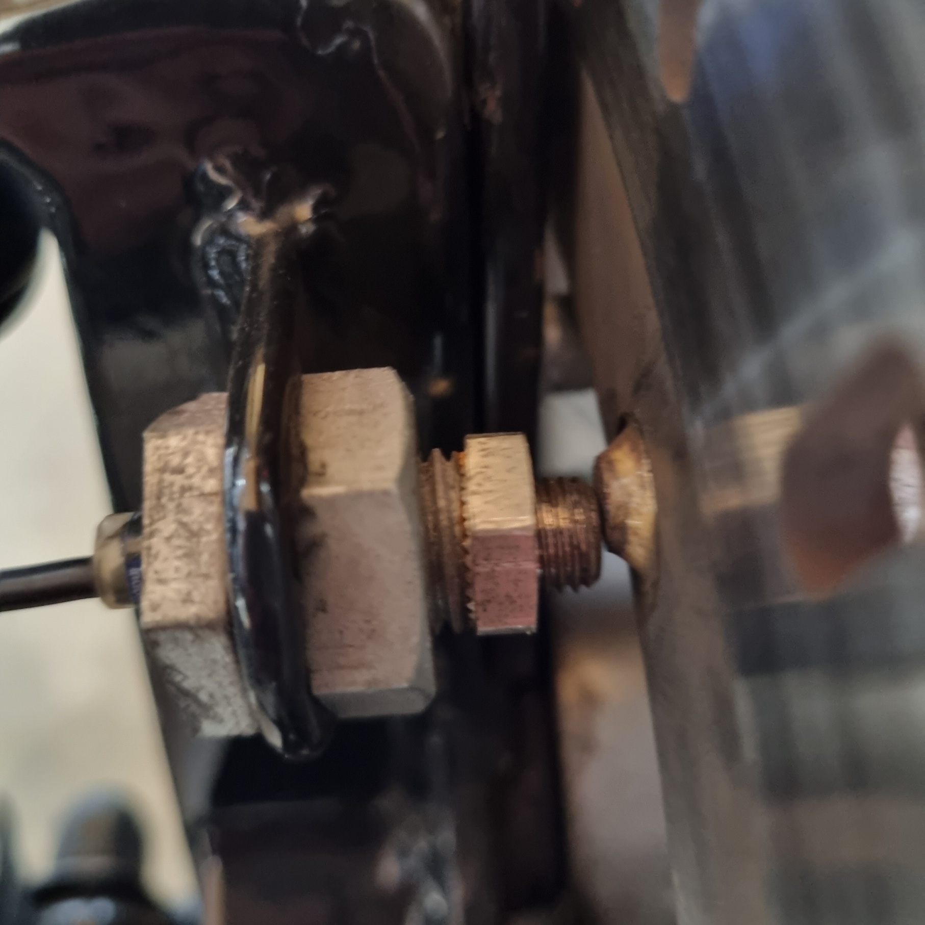

Thanks for the information and suggestions. I've just rolled it slowly in the garage to look at the gap and found there are 2 magnets that appear soldered in place and stick out further than any of the fasteners. The gap is very close (see picture).
I get no speed indication so it it isn't picking up the fasteners or magnets in it's present position.

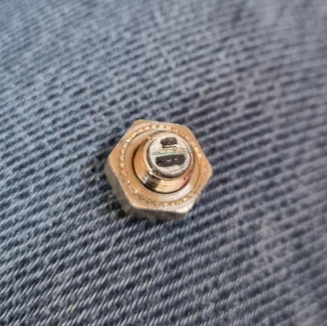

I looked to back the sensor off and the head fell apart :shock: at least that answers that!
This might explain the lack of reading

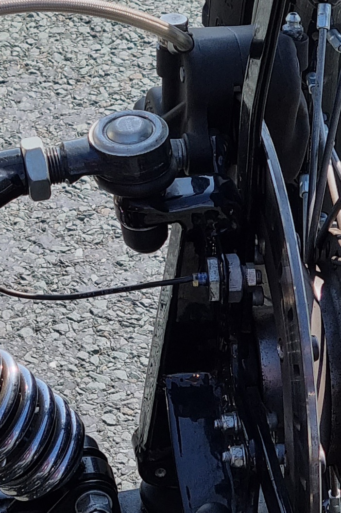

Post by Richard and Pat » Sat Jun 18, 2022 4:26 pm
Changed two magnets for ten BZP [not stainless] bolts [not Allen fixings] on advice from Mr. EDP and used webs in disc [ten] and reprogrammed as described. Speedos now solid and exact reading being shown. Two pence piece is the gap required. This from the horses mouth.
