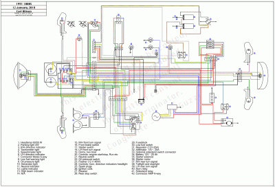

- Posts: 927
Re: Moto Guzzi wiring loom
Is this any good Henk?
If it is too small I can send via WeTransfer [a web site for sending large files].
Thanks Richard ,
That scheme is great i can easly enlarge the image that Will be a great help.
