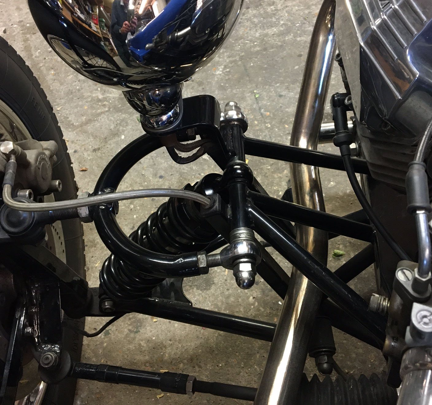

I recently started playing around with caster angles and was surprised that my caster was at 0 deg according to the level on my mobile phone.
I was reading on another post about adjusting the caster with shims. I have a Type 3 with the standard non adjustable upper A-arms. The only shims I could see are the washers that are next to the poly bushings. One on each side of the bushing/ 4 per a-arm. I ended up grinding back part of the upper A-arm mount so I had room for some shims to be able to shift the a-arm back thus tilting the upright back.
After doing this I have 2deg of caster and the handling is much much better. It still doesn’t have the 5 deg it should have according to the numbers I have been reading. How are you guys adjusting caster ? Are the large shims by the bushings the ones you are using to adjust caster or did you have additional shims in place that you could move around.
I think I could do the same to the lower A-arm but shift it forward to increase the caster to about 4deg. I think I need a more accurate way to measure the caster and will look into that first.
Any thoughts from you guys?

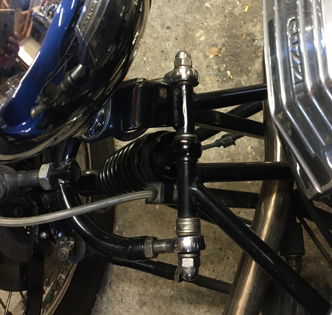

When I originally built, I used the adjustable top wishbone which was fine with the original shockers.
I've since upgraded to the comfort spec which involved slightly longer shockers and modified bottom wishbone.
I have shimmed out with washers to give me 5deg.
Evident on the picture that it could do with a modified top wishbone which I believe is available from Al.
With 0deg caster, yours must have handled like a blind pig.
Just sayin!

I just had a thought. Are the standard non-adjustable upper A-arms symmetrical? By that I mean can they be installed upside down? If they have a setback built into them and they were installed upside down then the set back would actually be set forward giving me the 0 deg caster. Just a thought. I will investigate further when I have time.
Posts: 90
Re: Caster angles???
Post by Spaniard » Sat Oct 09, 2021 1:54 am
Well after some measuring and playing around with suspension geometry I am now at 3.5 deg caster angle. I took it for a drive and it is much better. It feels much more stable at 70 mph. It may be that I got used to driving it with 0 deg caster and now at 3.5 deg is so easy to drive. I will leave it alone for now but I am sure I can increase it to 5 deg by shimming the lower A-arm forward.
