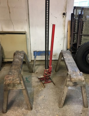

This is the kit that I use for getting my T3 Triking on and off build stand, takes me about 20mins single handed.
The high lift jack is used (on left side close to wheel, with boot off and spare petrol can removed) to lift the back up enough to get the small trestle under chassis.
I have a small metal square welded to chassis to prevent jack slipping but a bolt through the floor would be adequate.
Next lift the front end up with h/l jack, using the badge bar tube through front of chassis. This is when you find out that there is more weight on one side than the other.
Place the 2 big trestles under the front wheels, with wooden chocks to prevent rolling.
Return to rear with jack and lift up further to be able to slide under my wheeled build trolley.
Lower the back onto trolley.
Lift front, remove big trestles then lower front onto trolley.
Now ready to push around the workshop.
Note: I have stabilisers welded to the h/l jack.
Warning. Lifting any vehicle off the floor is a risk, take care. I accept no responsibility if it goes wrong.

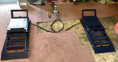

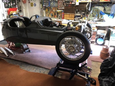

Following an expensive bout of damage to another car when jacking the Triking to get it onto boxes made from Scaffold planks I immediately downed tools and sent for a set of these and can thoroughly recommend them and the company that supply them. https://cjautosheywood.co.uk/product/hy ... ity-cr012/
YouTube: https://www.youtube.com/watch?v=NKm_TgBpOBU
I bought the heavier duty ones but could have spent a little less with the 900kg set as the Triking is around the 360Kg mark.

I like the red little flat jack / lift. Three of those might just get it high enough to put it on a stand like the blue one you have. Time to get the welder out make a stand and find a set of flat jacks.
