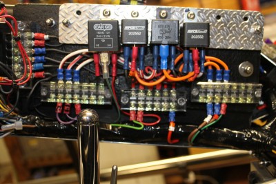

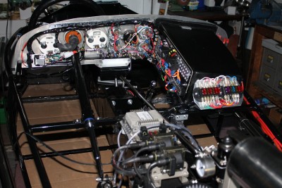

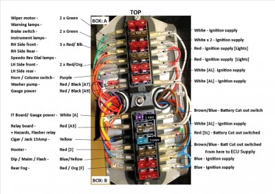

Post by Richard and Pat » Sat Jul 03, 2021 12:12 pm
Picture one underside of fuse box
Pic 2 Fuses
Pic 3 Position of relay board alongside glove box and fuse box on the front.
Pic 4 Relay board. I could have used smaller gang blocks.
Relays: Flasher, Twin horns, Hooter and Brake light switch. Been through three in eleven years on Squeaker one answer is to put a relay in.
