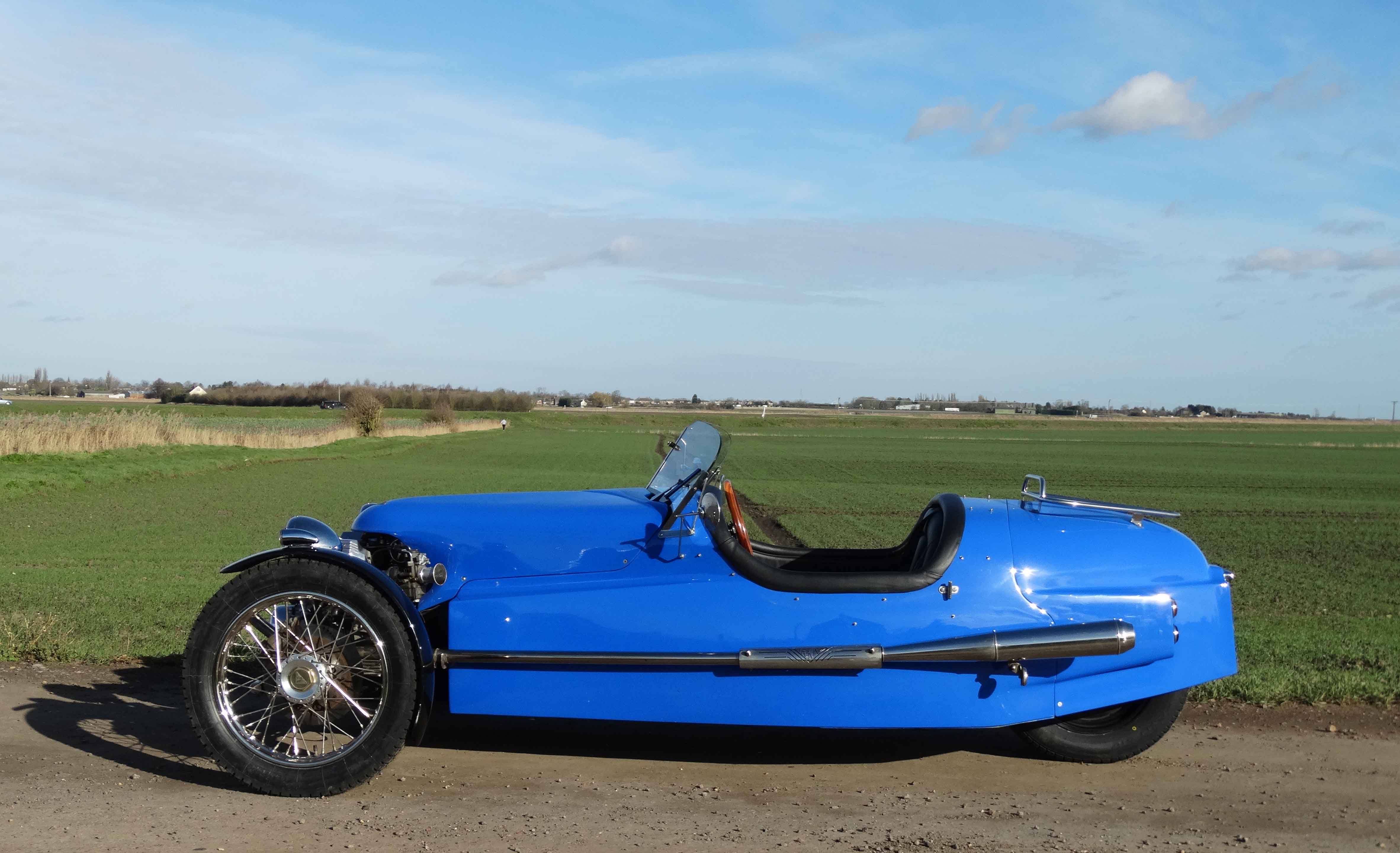

It was photo-shoot time today (for insurance agreed valuation) after fitting new tyres all round.
The guy at the tyre depot fitted the rear for me but was unable to balance it without the right mandrel.
Never had a problem with rear wheel balance anyway.
Fitted and balanced the fronts myself.
First, remove grease seal, wash bearings in white spirit, rinse and blow dry.
Clean outer races in the hub, assemble with the lightest of wd40 spray so there is no resistance.
Slacken the wheel nut back a bit. (Don't fit the brake calliper)
Now spin the wheel and slow it down to let it stop on it's own.
Put a marker at the top, add stick on weights (using blue-tack temporarily) at the inner top of the rim until the wheel will stop in any position when rotated.
Once there is no return rotation after stop, stick the weights on permanently.
Now assemble up with grease properly.
Works for me!
