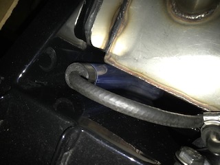

Several of us run the overflow pipe to up by the petrol tank and end in a bottle. I have used a Redex bottle as it fits between suspension support and tank. The old hair dye bottles with flat sides were good but the manufacturer changed the design going to round ones. [No not me I don't have enough hair to dye]. The end of the tube is in the bottom so expanded oil returns to box.
Oil bottle.jpg (22.56 KiB) Viewed 17675 times
