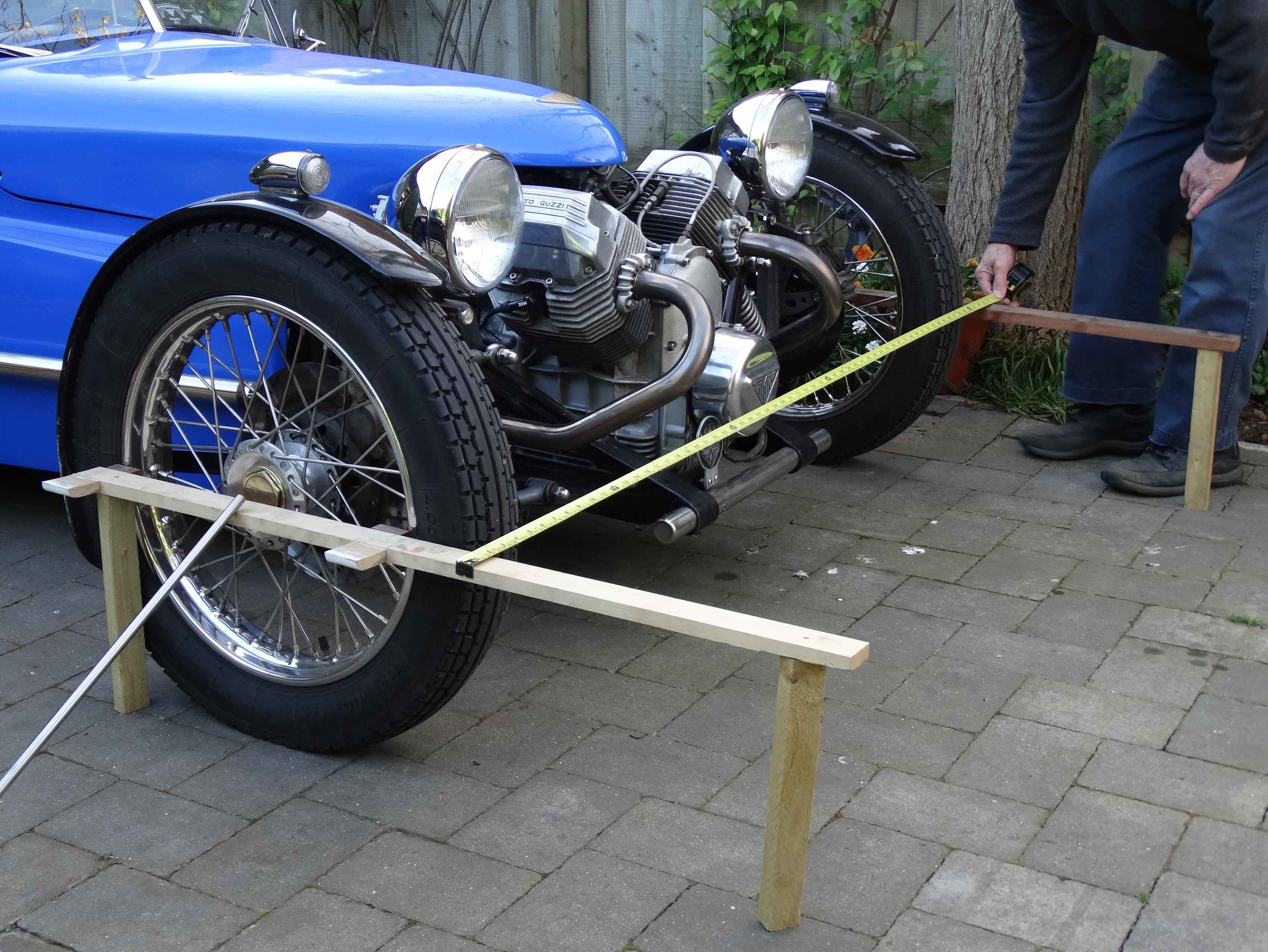

I'm a straightedge and string man myself, but is there a 'best practice' method for Trikings? And what's the consensus on toe-in amount?
I found a bit of feathering on my tyres so must have cocked up last time I adjusted...

3mm toe in is about right.
Picture shows how I do it.
Note small blocks of wood glued to straight edge to contact rim.
Don't forget to roll back and forward everytime you adjust to settle the tyres on the ground.

Thanks for the replies.
Both are a definite improvement on string. I'll knock up some wooden tracking gauges as per the picture whilst keeping my eye on Ebay for a cheap Trakrite.
