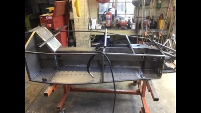

Got än email last night that the frame is being bulit. On the outside my beard may be getting more gray but on the inside im am a twelve year old boy getting the best christmas present ever.

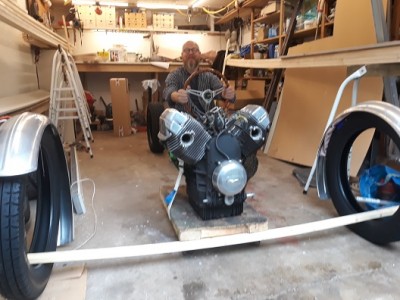

Finally all four wheels have arrived and i'am just waiting for the parts in between. :D
Recommended Metzeler in the front and Continental for the rear. The fourth wheel was sold as "brushed aluminium" but i would more call it whipped. Hopefully it can be polished to a nicer finish.
The fenders needs som adjusting but will probably fit fine.

Post by Richard and Pat » Sat Jul 04, 2020 3:31 pm
Excellent news! Where did you find the mudguards [fenders]? I have just fitted some similar but shorter length so will need some mudflaps added. I had to pack out the mounting and on the ones I found cut out the sides a little to allow the wheel to slide on / off.
